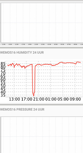

This is what i’am seeing; 1 chart works on this occasion 2 charts no data…
