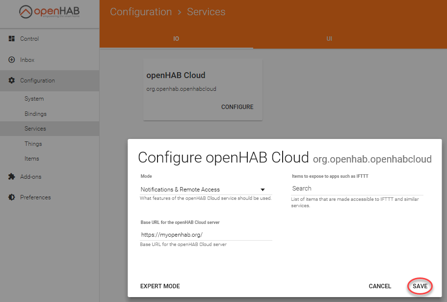

but openhab was not connected.
I was hoping to restart the bundle via the Karaf Console, but did not find a bundle.
Then I saved the Cloud Connector without any changes under Services via the Paper UI.
and see there …
2017-11-23 23:34:09.855 [INFO ] [io.openhabcloud.internal.CloudClient] - Shutting down openHAB Cloud service connection
2017-11-23 23:34:09.869 [INFO ] [io.openhabcloud.internal.CloudClient] - Disconnected from the openHAB Cloud service (UUID = UUID, base URL = http://localhost:8080)
2017-11-23 23:34:10.252 [INFO ] [io.openhabcloud.internal.CloudClient] - Connected to the openHAB Cloud service (UUID = UUID, base URL = http://localhost:8080)
a few seconds later, my openhab was online again.
