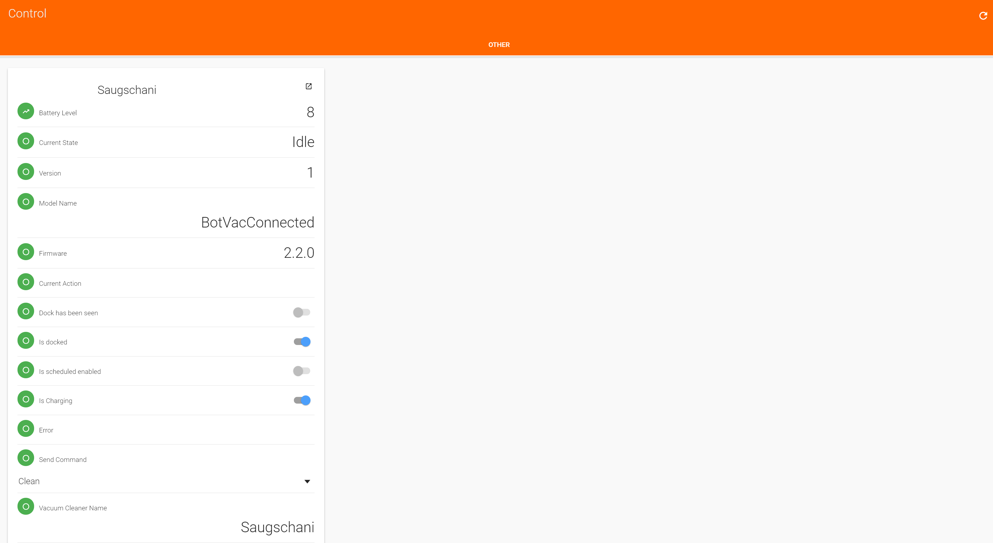

Hello i am very new to OpenHAB but i get i to run on my homeserver.
The first thing i have done so far, i added the Neato Botvac binding. Everything worked till the point when i wanted to send a command to the Neato from the OpenHAB->PaperUI->Control.
If i change the status from the Neato, eg. i disconnect him from the station i see it under control. But i i want to start the Neato or something like this, nothing happens.
Had anyone of you the same problem? Or do anyone of you have some advise what i can try?
thanks
Try and paste here both .things and .sitemap files, so we can check for typos or something.
At the very beginning, I was lost between channels, links, things etc… and I was making silly mistakes writing those files because of that :slight_smile:
P.S.: Also an excerpt of the log would be helpful
Attached a picture from paper ui controls
and below a few lines from the log
] - Error when getting Robot State. Error message Timeout waiting a response from robot
