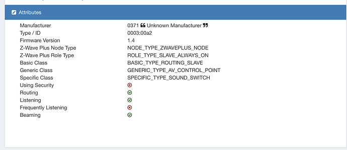

I have the ZW162-C (i suspect -C is the revision) and I can see now changes on tone etc… should I try to add an improved device version for this in the database? @Bruce_Osborne what you suggest?
Time to look at firmware versions. I like using HABmin for that.
Configuration → Things → [thing] → Atributes (all the way at the bottom).
Here is one of my devices.

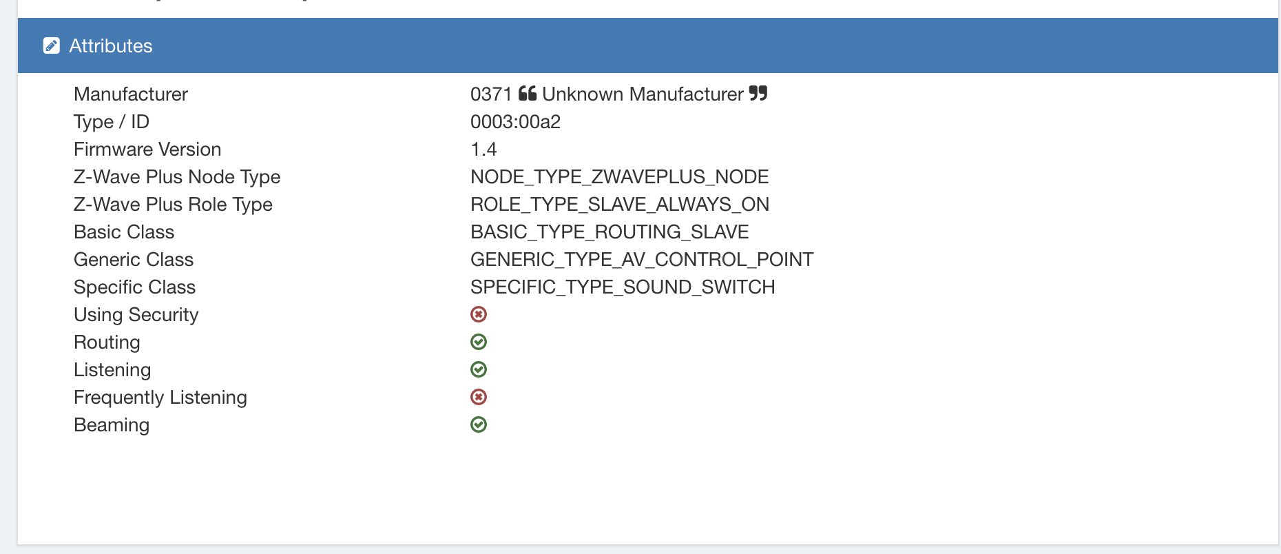

My Aeotec Doorbell reports this:
bought today - https://products.z-wavealliance.org/products/3292
Good. I will try & dig out what version we started with. I think I still have the files at home.
EDIT: The Siren 6 from last August was also version 1.4.
