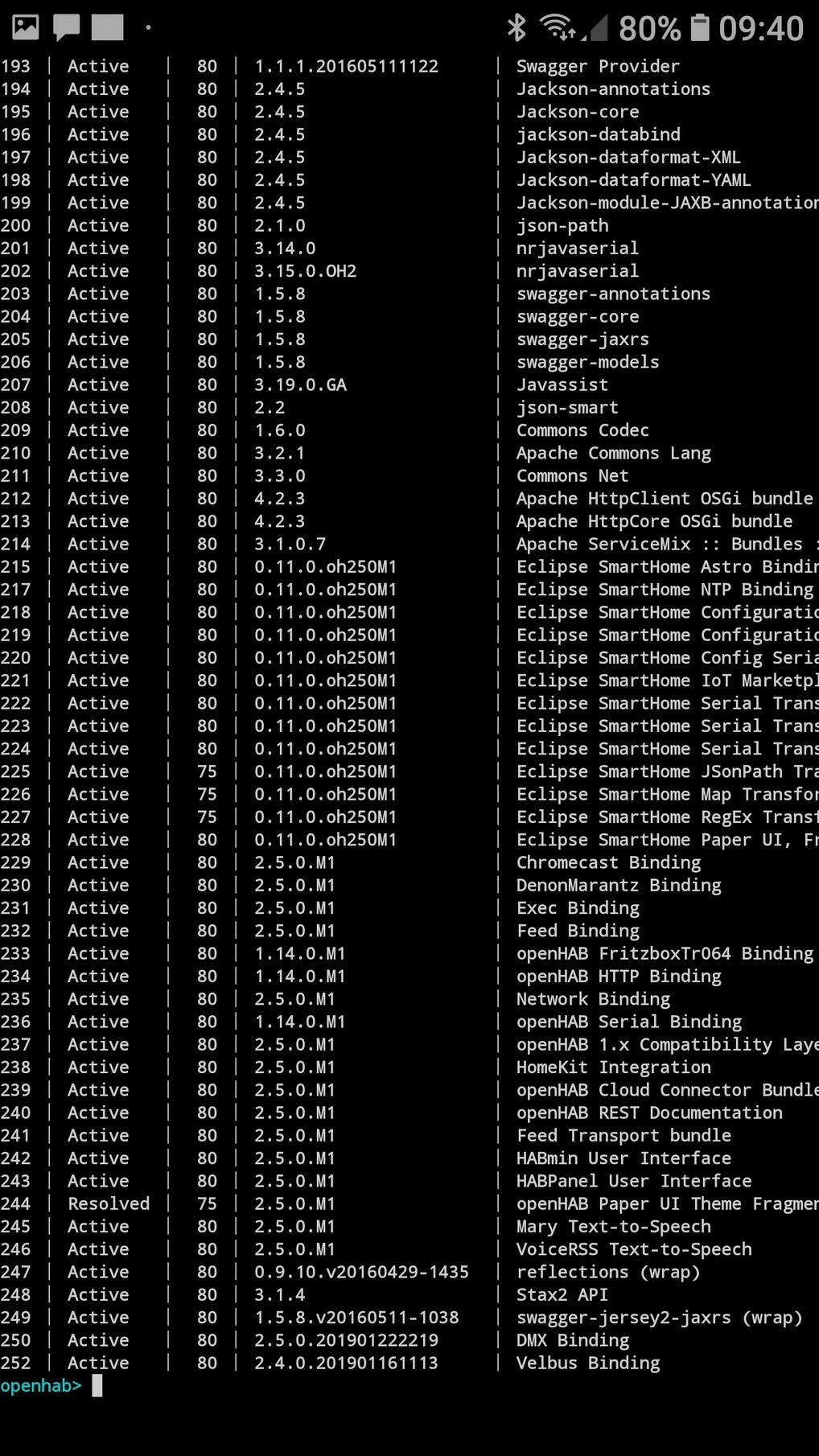

If you use the Karaf console with bundle:list you’ll see if the Velbus binding is “installed” or “active”
bundle:list -s |grep elbus
Without the serial binding, Velbus was showing as “installed”, but when I tried to activate it, it threw a dependency error.
Adding the serial binding got it working without any further fuss.

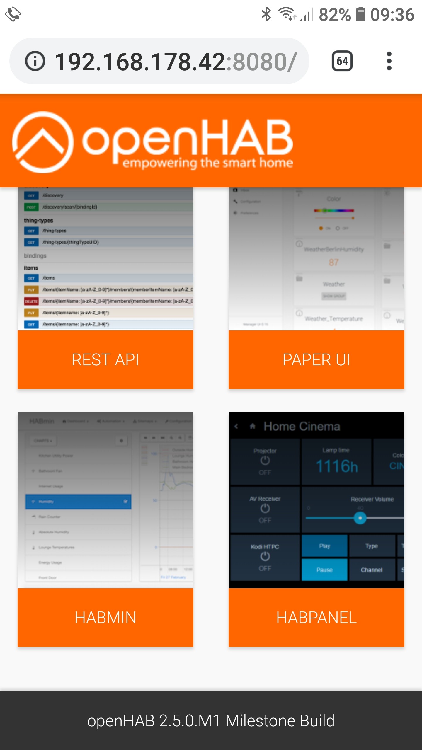

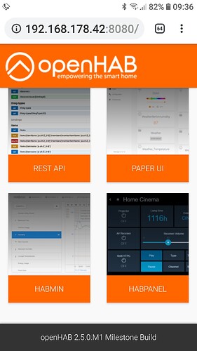

got the same thing, So I moved to 2.5M1
The velbus binding does not work in the new release even not when you add the feature:serial …
That’s strange.
I’m running 2.5M1 and the binding is working perfectly.

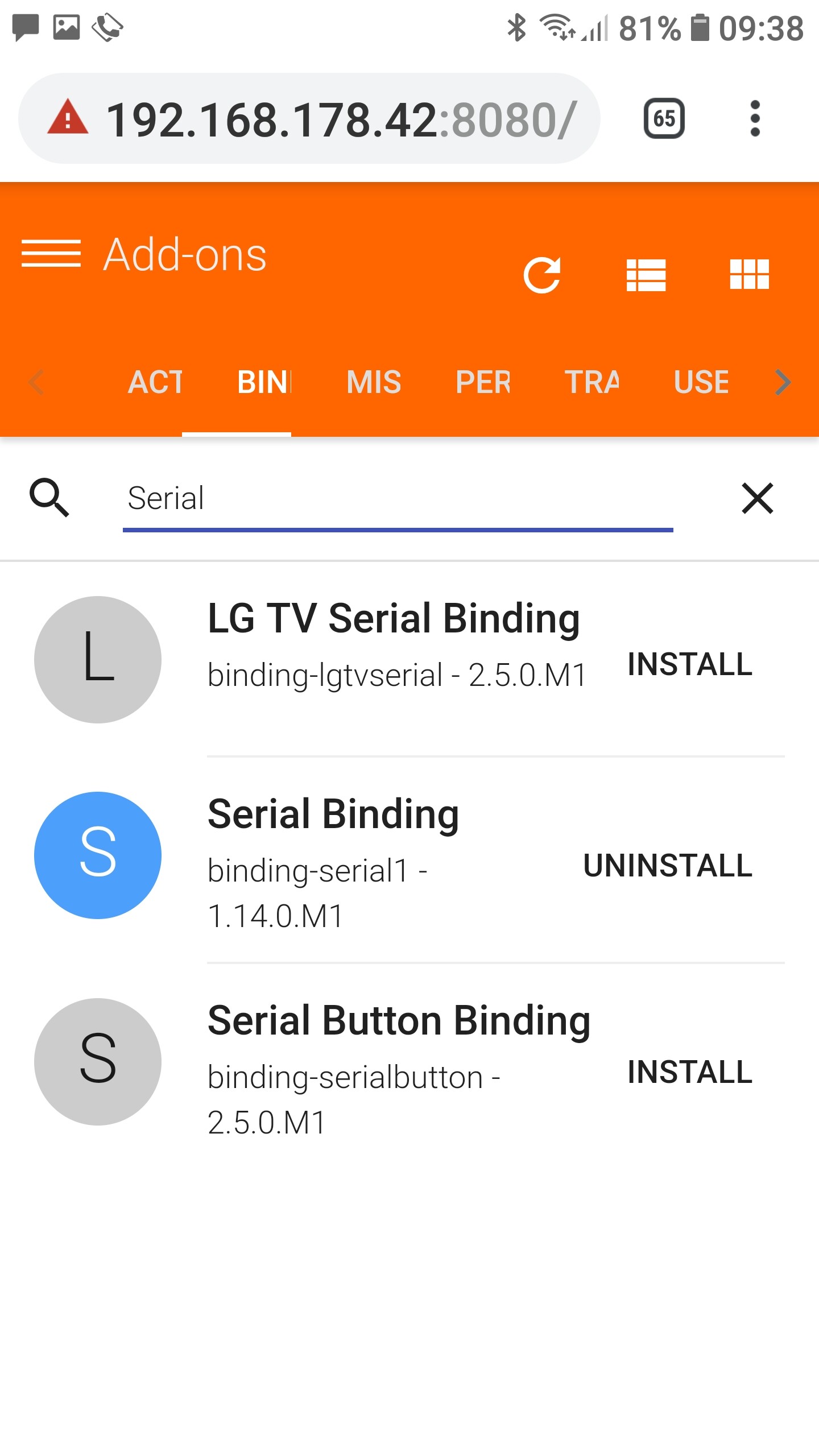

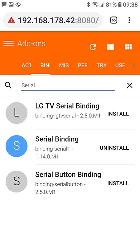

Did you load the serial binding from the Karaf console or the PaperUI?
bundle:list show the Velbus binding as active
