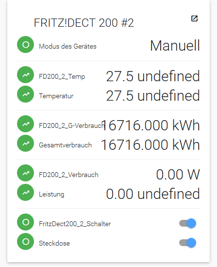

I noticed that my FritzDect 200 (switchable wall socket with temperature and usage) has problems with the new âunitâ conversion. PaperUI screenshot below.
Entry in the logs:
2018-05-31 09:20:17.151 [WARN ] [ui.internal.items.ItemUIRegistryImpl] - Exception while formatting value â27.5â of item FD_temp with format â%.1f %unit%â: Conversion = âuâ
default.item:
Number FD_temp âFritzDect200_Tempâ (gFD, gSmartPlug_others) { channel=âavmfritz:FRITZ_DECT_200:192___*:087610369753:temperatureâ }
Is there anything I can do to correct this or is this a âBindingâ problem.
Thanks for further information.
Lots of Greetings
Eckart
I did run into it in a snapshot earlier this year. It was a unintended feature at first, so the transformation was just aligned with the documentation.
Hi Eckart,
Please change your item configuration according to the docs. You have to use e.g. Number:Temperature. I am pretty sure that will solve your problem.

Hi Christoph,
thanks for your help.
It did solve half of the problem, the other half was solved by removing the Fritzdect from âThingsâ in the PaperUI and then adding it again.
Thanks a lot!
