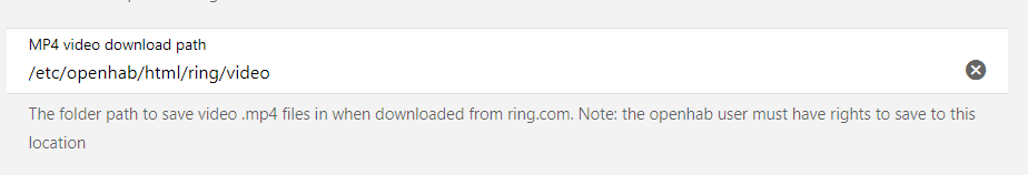

This piece is important on the Thing setup, where the ring videos are stored. They are around 20 mb for every event.
