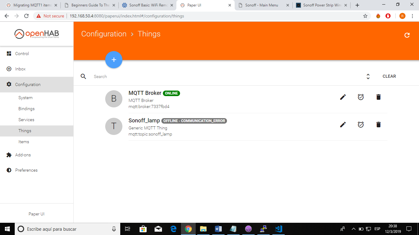

i followed the both documentation and i still have some problems

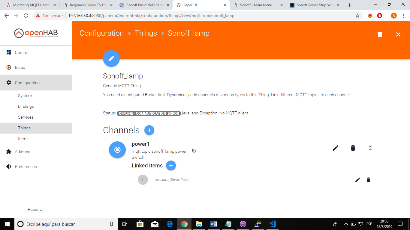

this is the configuration i have in the channel
this is my code for the thing file:
Bridge mqtt:broker:Casa_Wayak [ host=“192.168.50.4”, secure=false ]
Thing Topic lampara “lampara”{
Type Switch :pool_lamp [ stateTopic=“stat/DVES_DF31A6_fb/power1” , commandTopic=“cmnd/DVES_DF31A6_fb/power1”, on=“ON”, off=“OFF”]
and this is my code for the item file
Switch SmartPool “lampara” {channel=“mqtt:topic:sonoff_lamp:power1”}
That could be the known issue of the 2.4 Version of the binding (already resolved in the snapshot version). Simply restart openhab without doing changes to the MQTT Setup.
