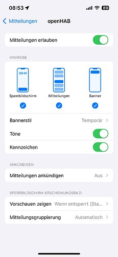

Yes, looks exactly like yours.
App Version is 2.4.56 on iOS 17.0.3
Mine is 2.4.60 - Testflight
My wife and I, both iPhone user, have the same problem. Me iOS 17 and my wife iOS16 and both app version 2.4.56. Everything is checked on in the settings. Also I deleted the app reinstalled it but no luck.
