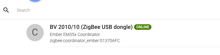

I had trouble initially adding the Bitron Zigbee dongle as it wasn’t getting detected automatically or when I tried to add it manually. I reboot the Pi and unplugged the dongle and plugged it back in and this seemed to register it.

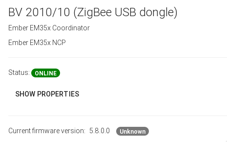

Could you tell me the firmware version of your Bitron Video Coordinator?
You can hopefully see it in PaperUI:
If you can’t see it in PaperUI, it is logged during startup with debug logging enabled:
2019-12-27 19:26:26.378 [DEBUG] [systems.zigbee.dongle.ember.EmberNcp] - EzspVersionResponse [protocolVersion=4, stackType=2, stackVersion=5800]
Thank you!

Hi @mrfrh, I am not seeing the firmware in the Paper UI and haven’t had a chance to setup debugging. I’ll get it working tomorrow and check what the firmware is and let you know.
FYI This firmware version display bug was fixed in the latest binding.
I have 2.5 installed, is that the latest or is there a new version?
2.5.1 should have been released today and it should be fixed in that version.
