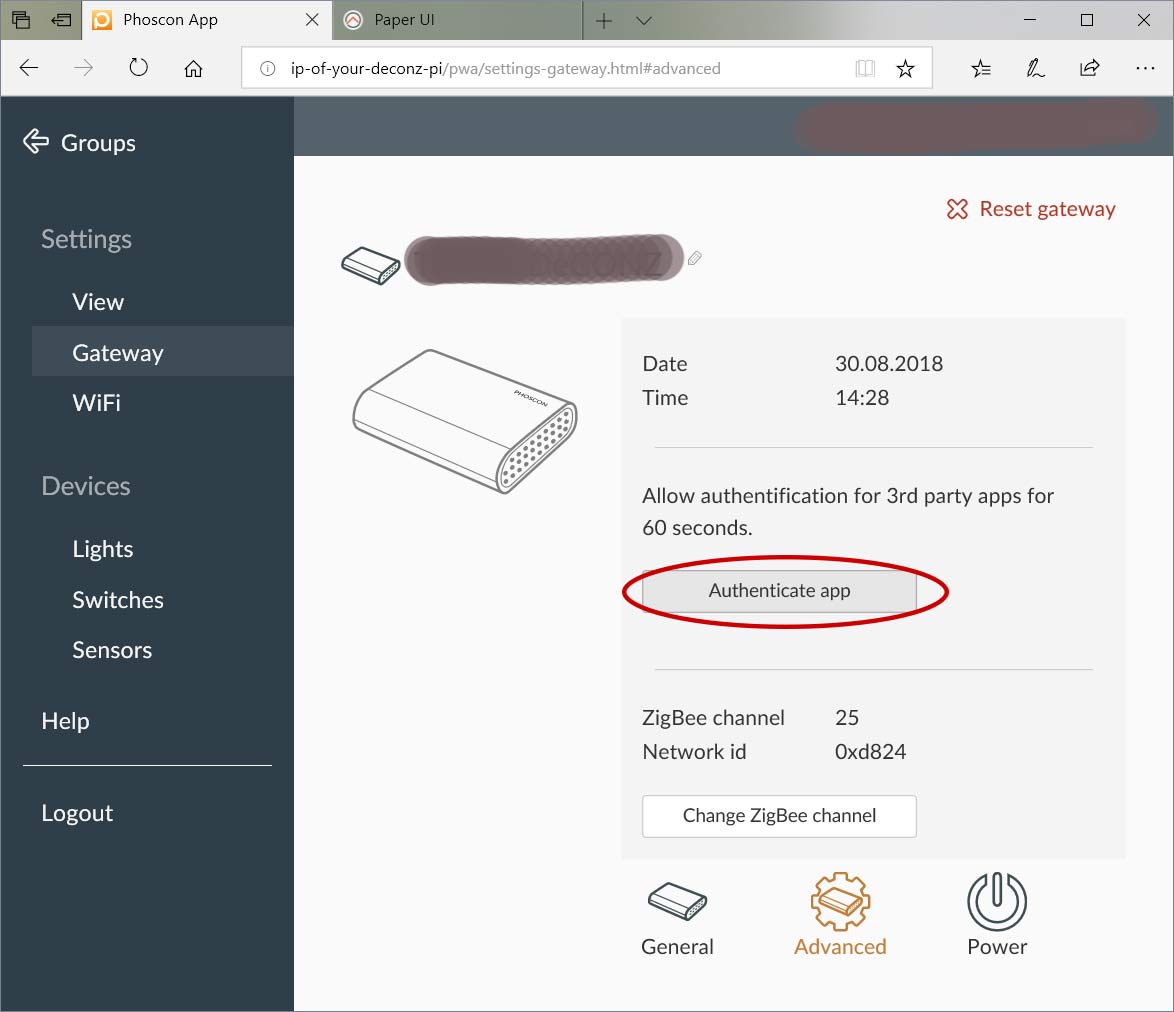

Here are some screenshots, how to connect to Raspbee via Deconz til the native support by @chris’s Zigbee binding is merged.
So let’s start:
(assuming, you have installed Raspbee/Deconz as written above and have a openHAB instance running somewhere else)

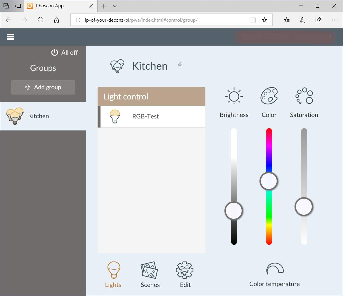

Attach some light(s) to the Deconz. Check, if you can control your lights from within this web app:
Install the HUE binding via the PaperUI and go to the inbox → “+” → HUE Binding → add manually:

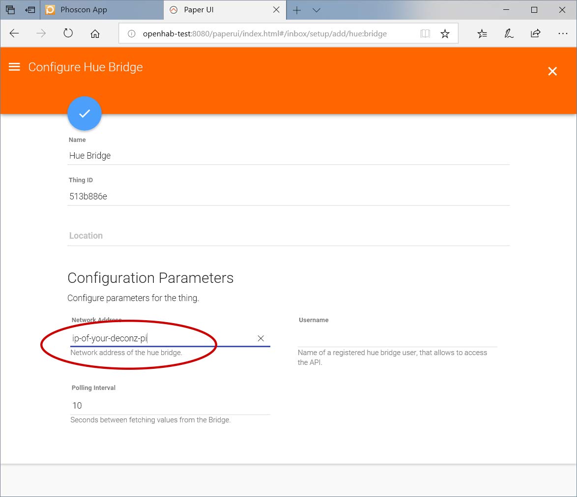

Select a “HUE Bridge” to be added. (a genuine HUE bridge will be discovered automatically, but the Deconz-HUE must be configured manually).
Before proceeding, go back to your Deconz window and click in the Gateway → Advanced configuration → Authenticate app. This does the same as pressing the connect button a real HUE bridge:
Back to the PaperUI - Now put the Ip address of your Deconz gateway in and click on blue o.k. button:

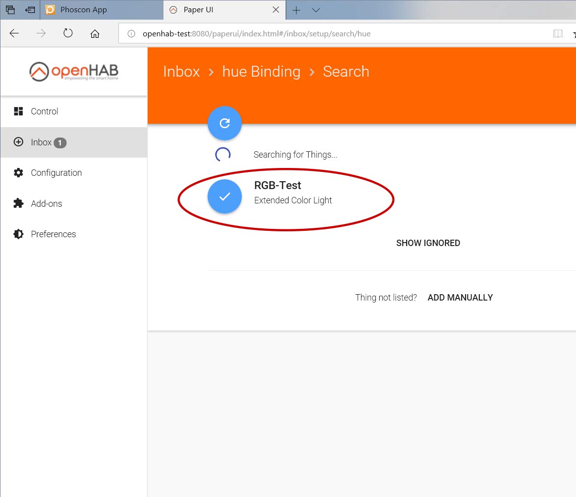

Your gateway should now getting connected and the attached lights will be discovered immediately:
Click on the blue o.k. button(s) to finally add the lights to your list of things. You’re done!

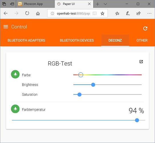

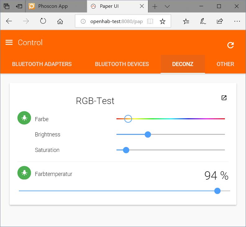

If all went right, you’ll be able to control your lights from openHAB:
I have to admit, I won’t recommend this to somebody who is asking which stuff to buy. This does more or less the same as a genuine HUE bridge or probably any other Zigbee bridge which can be controlled from openHAB (Osram Lightify, IKEA tradfri). Building an own bridge similar to it is likely waste of money.
But if one already has a Rpi and a Rasbee/Conbee this can be an option to make use of it until the native support of the Raspbee is there :wink:
