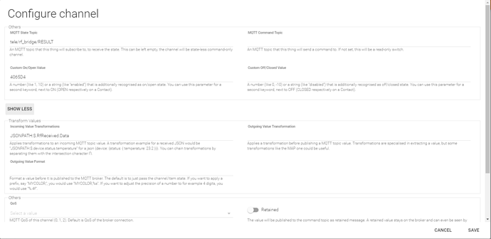

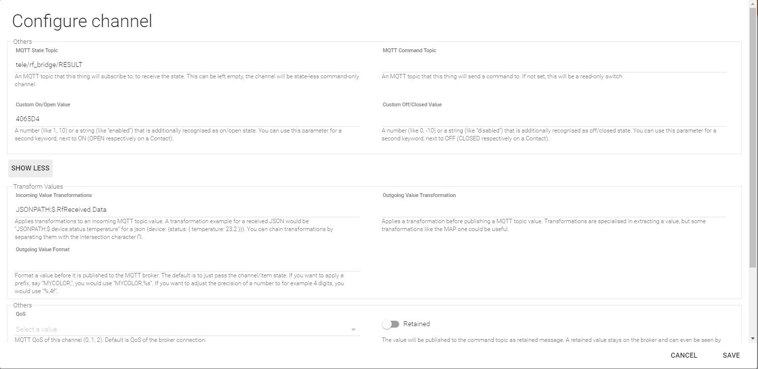

Here (above) is the MQTT thing in paper UI.

Setting a channel for each RF event was done like this;
Because each device sends the same topic, all the channels get all the event for each button/sensor.

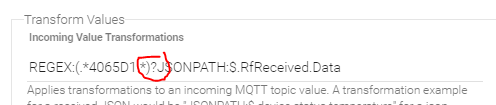

To fix this, the Transformation was changed to;
REGEX:(.*4065D4.*)∩JSONPATH:$.RfReceived.Data
This filtered out the messages that were not for the correct device, without leaving errors in the logs.

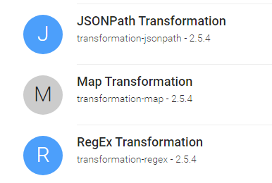

I had 2 errors getting this to work. Firstly ensure you have the following bindings installed to make this work;
Secondly, I had issues with the “∩” which is required to get this to work
I was able to paste it correctly and it worked for a while but the character reverted to a ? when I changed any other channel for the thing. This seem to be because of the encoding used to write the json config files back.

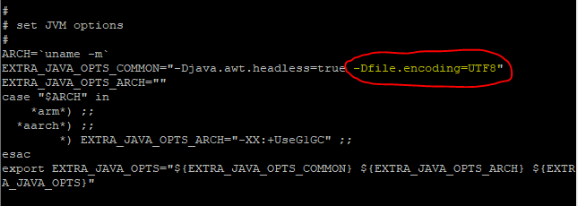

To fix this I needed to edit the file on the server called;
/openhab/runtime/bin/setenv
and make this change;
Then restart openhab.
After this, the config files were saved correctly and all worked.
