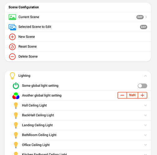

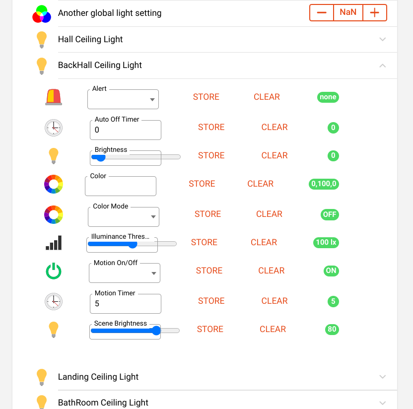

I am working on a Scene Config UI inspired by this widget
I haven’t started any of the metadata and var stuff yet, I am still trying to use repeaters and filters to dynamically populate a UI first.
I will repeat this for Heating, Alarm, and other stuff if I can get this working.

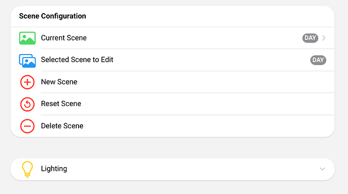

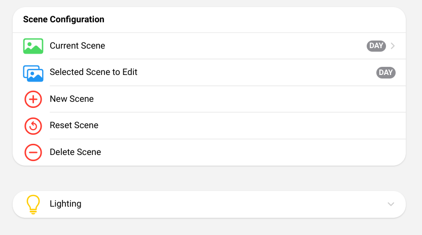

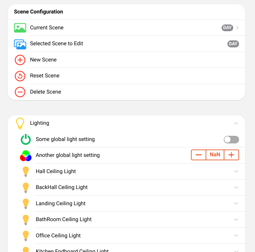

At the top there will be basic controls for selecting, creating, deleting, and resetting scenes.
then accordion open the lighting
There can be a few single, hardcoded items, then the lights are loaded dynamically using oh-repeater, and then each light has it’s properties loaded using a second repeater inside an accordion. There will be an input control, buttons to store and clear values, and a badge to show the stored value
The problems I am running into:
Setting an appropriate control for each property -
Originally I thought I could use an expression in the ‘component’ field to set oh-toggle-item, oh-stepper-item etc, but this doesn’t work. It seems you can’t use an expression here.
My current version is using the f7-list-input component which does allow me to use an expression in the ‘type’ field so I can set a different input control for each property type.
How can I format and set options for these f7 components?
How can I populate the dropdown menu for the ‘select’ type?
How can I set min, max, and show labels for ‘range’ type?

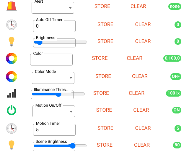

How can I format the range slider and other input boxes to fit properly? I’m using a forced width of x% to make this illustration fit, but this doesn’t seem like the right way to do it to scale properly across devices.
I’ve seen the f7 docs, but it’s not in YAML.
Is there a better way to do this?

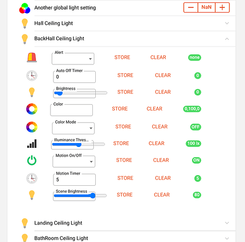

And formatting components in a row.
Can anyone tell me how to format the rows shown here:
You can see how I did this in the YAML below, but I’m not doing it right.
Each row should be properly spaced and lined up neatly with all the rows beneath, and It needs to have more space to interact with the input controls if using on a phone.
Maybe STORE and CLEAR could be stacked on top of each other, and maybe the badges should be center justified? Or have two rows for each property? Any advice on row formatting would be appreciated.
Where can I find a list of available classes?
I keep seeing things like this in examples in forums -
class:
- align-items-center
- display-flex
But I don’t know where they come from, what is available, or what a lot of them actually mean. But I suspect they could be useful for something like this.
