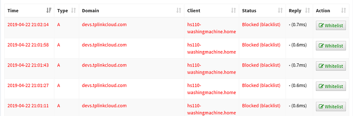

They also work without being connected to the internet. If you do block them though they get quite chatty trying to call home.
All my IoT kit is on a different SSID and I use Pi-Hole. Here is one of the tplinks getting upset.

Would the traffic be enough to impact your wifi quality if you only had one SSID? I imagine that could be the case if you had a lot of devices firing off requests every 15 seconds and getting blocked.
Unlikely unless you have a large number.
I keep all iot stuff separate because a) I don’t trust a lot of the Chinese tat I buy and b) its easier to manage / secure.
