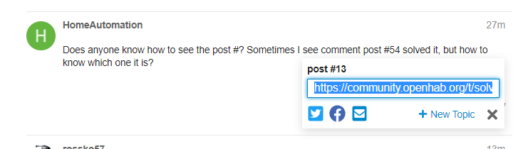

Does anyone know how to see the post #? Sometimes I see comment post #54 solved it, but how to know which one it is?

I just poked around and found at least one way. Click the link icon on the post:
You will get a popup.
By the way, is you use that link, strip your username off the end of it.
Also, if there is a solution, in the first post you can click the post number to go to that post.
