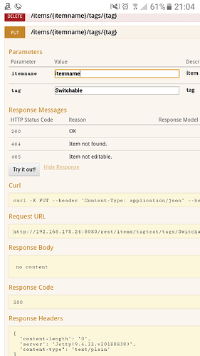

Please try this:
  • In Paper UI, make sure that the Addon Misc → REST Documentation is installed.
  • Open the REST Documentation: http://…:8080/doc/index.html
  • Open items, PUT /items/{itemname}/tags/{tag}
  • Enter the name of the item and then the tag and press “Try it out”
where {tag} is: Switchable
Your “item” in rest api should result like this:

Yes, only: “Switchable”.
Beautiful. That worked great. Thank you!
Is this a persistent change? Where does that tag get “saved” so that it’s still there on the next reboot?
Yes. After you have pressed “Try it out” it’s been written into JSONDB.
