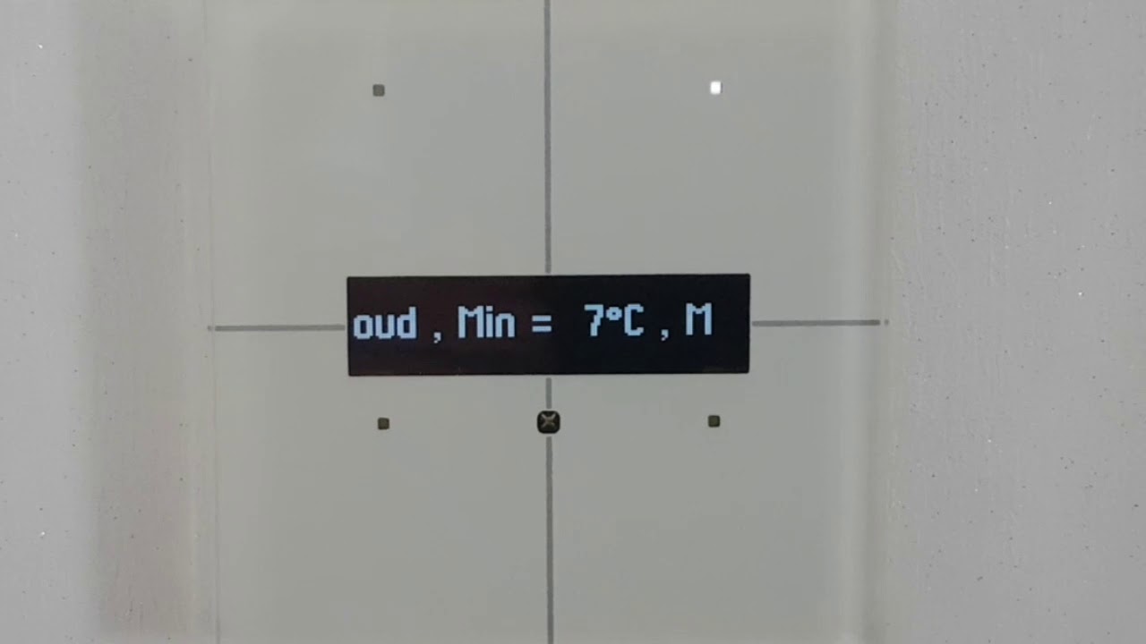

[SOLVED] BBC weather RSS Latest Title split to <64 characters for Velbus OLED (AKA Splitting Strings)
I wanted to be able to display a short string on the Velbus OLED panels that gave a description of the weather.
(I’m sure that Cédric will add the Edge Lit Oled panels to the Velbus binding when his schedule permits.)
I’ve managed to use a simple rule to copy “Now playing” information from music systems to the OLEDs of Velbus panels, but the weather is more of an issue because the BBC RSS feed can be longer than the 64 character limit of a Velbus panel.
(Also it takes too long to scroll across)
The only things I needed to add to openHAB2 were the RSS Feed binding and a Thing that polled the BBC RSS weather feed for my location.
The Virtual Switch called “OLED_Weather” is only there so that I can switch on or off the RSS feed on the OLED panels
I’ve created this rule that seems to do the trick.
I’ll confess that yet again I don’t really know what I’m doing, so the weather0 value isn’t used, but i don’t know how to achieve what I want without setting it up. - (Turns out that it is totally redundant)
Any suggestions for how to tidy this up would be most welcome.

Well, I really don’t understand how the split command works, is it splitting up to the stated character, or after it?
The incoming string uses a : mostly, but also a comma just to be annoying.
this line :
val weather0 = BBCWeatherRSS_LatestTitle.state.toString.split(',').get(0)
give a return of “Today: Light Cloud”
and val weather1 = BBCWeatherRSS_LatestTitle.state.toString.split(':').get(1)
creates a return of “Light Cloud” (the later being what I wanted)

So the incoming RSS text of
Today: Light Cloud, Minimum Temperature: 7°C (45°F) Maximum Temperature: 11°C (53°F)
can now be sent to the OLED panels as
xxxxxxxx.sendCommand("Weather = "+condition+" , Min = "+minT+"°C , Max = "+maxT+"°C")
which produces –
Weather = Light cloud , Min = 7°C , Max = 11°C

Which you stated and it appears to be born out in the code you don’t actually use. So why split it out in the first place?
Right, but I think the part you missed is that the weather1 line is operating on the entire text, not just on what is in weather0. Had you written it as:
val weather1 = weather0.split(":").get(1)
then weather0 would be a useful line. But as you should see, you don’t need that first line because the second Item in the list when you split the whole text on : will be the part you want anyway. So you can skip it.
My code should be (unless I have a typo) functionally equivalent to what your original code does. The important things to realize are:
  • calling split does not change the original text; each one of your weatherX lines is operating on the full text from the RSS feed.
  • split returns a list of the parts of the string split on the occurrences of ‘:’ in this case, excluding the ‘:’. So if you have the string foo:bar:baz, calling split(‘:’).get(0) will be foo and split(‘:’).get(2) will be baz. You are getting the Nth part of the String after the split. As with most programming, we start with 0 instead of 1
So just split the String once and save the list to a variable (parts). Then pull out the parts that you want and save those to their own variables.
You can’t use an aggregation function with String Items (what’s the AVG of a bunch of Strings?). Maybe you tried to do that?
This should be possible. I’d have to see what you tried.
In general, editing data (I’m calling Items data here for sake of argument) is safer than editing code. This is why I always fall on the side of making the changes in .items files and sometimes .map files and the like before I’d write a Rule that I would expect to need to edit in the future. It is easier to accidentally introduce subtle errors in code. If you introduce an error in a .items file, it will usually break the whole file and you immediately know.
Another good reason. Other approaches could be using an enable/disable proxy Item for each to turn it on or off. But Group membership would be much easier.
DOH! Dumb mistake. Get rid of the .get(1) at the end. It shouldn’t be there.
if(parts.size >= 4) parts.get(3)
So using the trinary operator (one line if statement)
val weather3 = if(parts.size >= 4) parts.toString.get(3) else ""
The size of the parts array tells you how many segments the String was split into.
You can do that too. Split on “,” and get(1). The use replace(“Minimum”, “Min”) and replace(“Maximum”, “Max”) and replace(“Temperature”, “”).
You can even do it in one line.
message = BBCWeatherRSS_LatestTitle.state.toString.split(',').get(1).replace("Minimum", "Min").replace("Maximum", "Max").replace("Temperature", "")
A most excellent and informative reply as always.
Thank you Rich, I really feel like I’ve learnt a lot from this experience.
Now I need to find a dark room with soft walls, as my (mostly wires and cable driven) brain has had the work out of it’s life.
