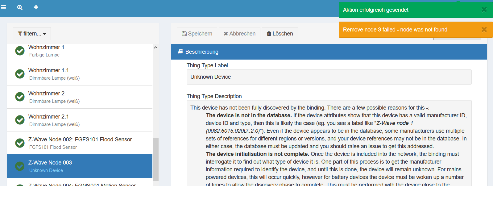

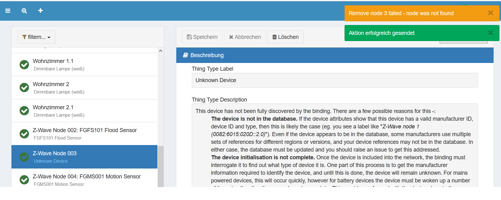

Dear @chris !
Node 3 is broken (the device doesn’ t work anymore).
Tried to set as failed:
Tried to remove node:
When I delete the thing and do a Zwave inclusion again, Node 3 appears again.
Any hints (I am on the Zwave - Binding Version from 8th of Feb.)?
Herbert
I think this means that the controller doesn’t think the device is dead. The controller only allows devices to be removed if it thinks it is not working and the “not found” error means it wasn’t on the dead device list.

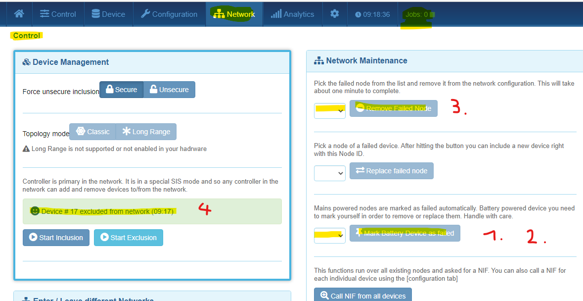

I finally managed to remove the devices using z-way-server (on RPi 3+, openhabian and raZberry/Z-way.me controller.
To make it clear for everyone who is struggling, here is the detailed procedure:
  1. Download z-way server and copy file (z-way-4.1.1_armhf.deb) to your raspberry. https://storage.z-wave.me/z-way-server/
  2. Install zway server (dpkg -x z-way-4.1.1_armhf.deb “destination folder location”
  3. Maybe you have to install corresponding “libarchive” otherwise no devices are shown: In my case “apt-get install libarchive13”
  4. (In OH set device as failed and remove it, maybe this step is not needed. But I recommend to at least remove the thing)
  5. Stop OH Service (“sudo systemctl stop openhab.service” or see zynex’s post)
  6. Start zway-service (go to install locateion and type “./z-way-server”)
  7. connect to z-way using web browser “http://your-oh-server-ip:8083
  8. Go into ExpertGui Mode (Menu → Devices → “Manage with expertUI”) and follow the folloing steps:
  • Hover on “Network” and klick on “Control”
  • In the Network Maintenance Section select your device Node ID and click “Mark Battery Device as failed
  • wait 30 sec as stated until the job is done
  • Choose again your dead nod and click again on “Mark Battery Device as failed”
  • Now you should be able to select the Node ID at the top of the “Network Maintenance” Section and click on “Remove failed Node” → Sometimes it need multiple times to work…
  • In the “Device Management” Section it should state Device # “ID” as excluded
  • Close Browser and in ssh console press CTRL+C to stop zway-service
  • Start OH Service → sudo systemctl start openhab.service
  • Remove the device from OH Inbox if needed. It should not show up again while scanning.
I hope this helps.
