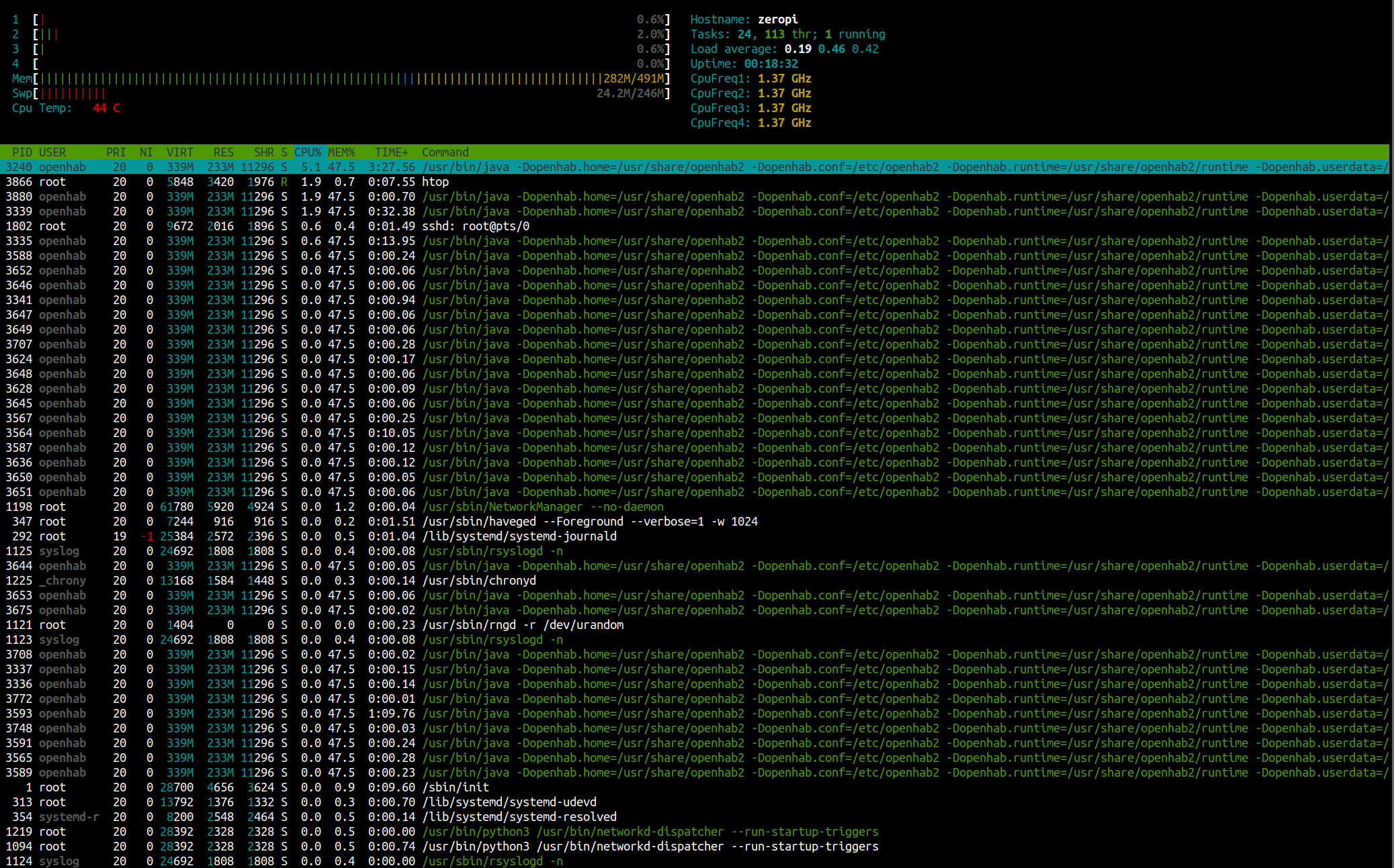

Test this way:
git clone https://github.com/armbian/config
cd config
./debian-software
It must work on any Debian based machine, not just on Armbian. It test on amd64 VM and running it now on most tiny board I found on my desk. Zero Pi H3 with 512Mb memory:
