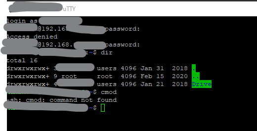

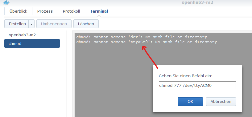

Basically I don’t know how I can enter the CMOD command in the Docker App in the DSM? It looks like this for me:
on my Raspberry (= openhab2 productive system) I go in via Putty … but here on the Synology I can’t find the right port … if it is one of these … it wouldn’t work:
I am stuck as “stuck”
are you passing it through to the container? you need to have the permissions set via ssh on the Syno not the docker.

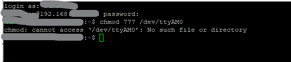

Mmmh, still have problems … I have now logged in with the user who also has docker permission
But CMOD still won’t work:
its “chmod”

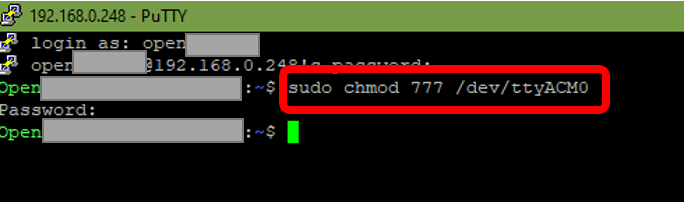

oh, silly me … but no difference:
are you root?
do a reboot with the stick attached and try again
its ttyACM0 not AM0

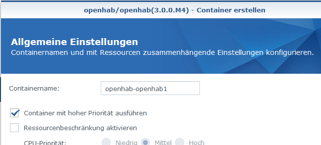

Okay, now it works … i’ve walked this path:

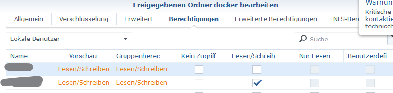

1a) give “high priority” zu Container:

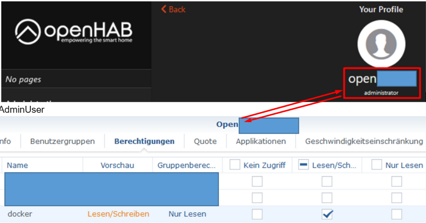

1b) be sure that the Openhab-Admin-User have has the correct permissions on the Synology:
1c) restart synology NAS

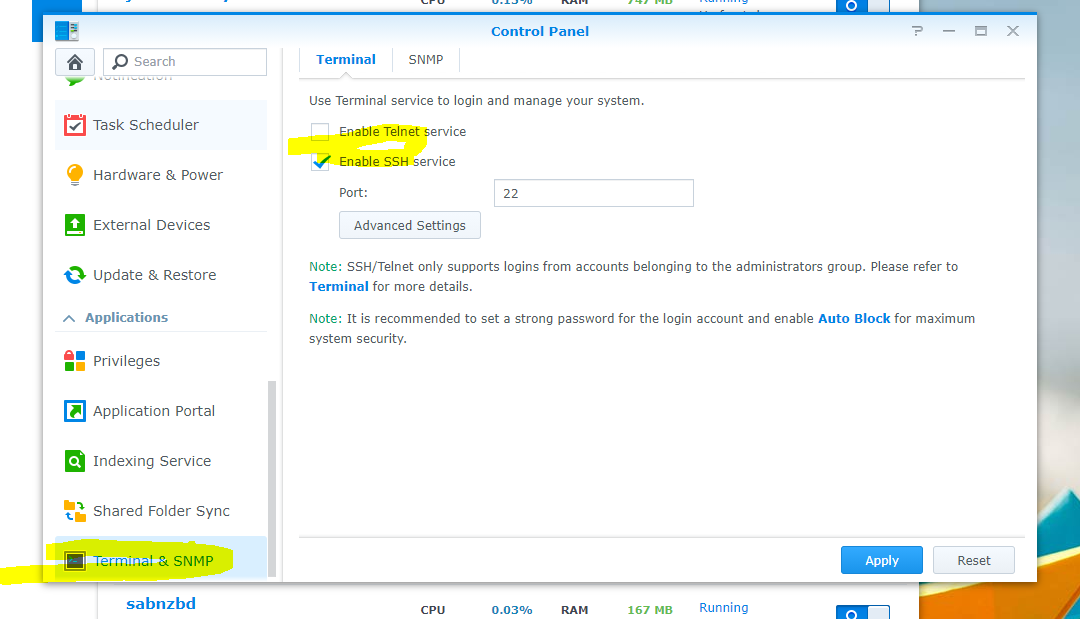

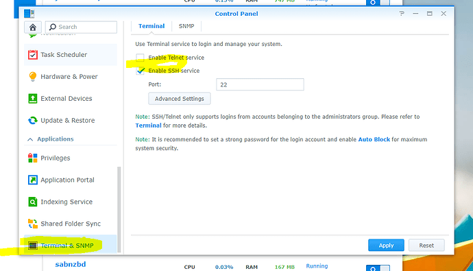

2) SSH to NAS with a AdminUser with appropriate access rights to the “Docker” folder:
2a) the user should look like this
2b) SSH to NAS with a AdminUser like this:
