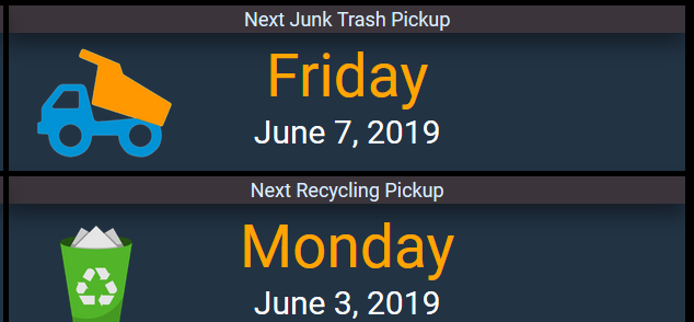

I use Google Calendars for a similar scenario…
I have calendars set up for Recycling, Junk Waste, Tree Waste, and School events that pull into OH. I use the information on a HabPanel display
I can tell you the setup process with CalDav was extremely frustrating and the documentation needs quite a bit of work as you seem to spin in circles without getting answers.
I’ll share my config files below in the hope you can gleam some knowledge…it’s been a couple of years so the exact details and hurdles are not so fresh in the brain.
I don’t see mention of your caldavPersonal.cfg file.
Let me know if you have any questions.

Here are my items…
DateTime    Calendar_Upcoming_Junk       "Next Junk Waste Pickup [%1$tA, %1$tB %1$te, %1$tY at %1$tl:%1$tM%1$tp]" <calendar> { caldavPersonal="calendar:Junk type:EVENT eventNr:1 value:START" }
DateTime    Calendar_Upcoming_Trash      "Next Trash Waste Pickup [%1$tA, %1$tB %1$te, %1$tY at %1$tl:%1$tM%1$tp]" <calendar> { caldavPersonal="calendar:Trash type:UPCOMING eventNr:1 value:START" }
DateTime    Calendar_Upcoming_Tree       "Next Tree Waste Pickup [%1$tA, %1$tB %1$te, %1$tY at %1$tl:%1$tM%1$tp]" <calendar> { caldavPersonal="calendar:Tree type:EVENT eventNr:1 value:START" }
DateTime    Calendar_Upcoming_Recycle    "Next Recyling Pickup (start) [%1$tA, %1$tB %1$te, %1$tY at %1$tl:%1$tM%1$tp]" <calendar> { caldavPersonal="calendar:Recycling type:UPCOMING eventNr:1 value:START" }
DateTime    Calendar_Upcoming_School    "Next School Event (start) [%1$tA, %1$tB %1$te, %1$tY at %1$tl:%1$tM%1$tp]" <calendar> { caldavPersonal="calendar:School type:UPCOMING eventNr:1 value:START" }
DateTime    Calendar_Upcoming_School_Name    "Name" <calendar> { caldavPersonal="calendar:School type:UPCOMING eventNr:1 value:NAME" }
DateTime    Calendar_Upcoming_House    "Next House Event (start) [%1$tA, %1$tB %1$te, %1$tY at %1$tl:%1$tM%1$tp]" <calendar> { caldavPersonal="calendar:House type:UPCOMING eventNr:1 value:START" }
DateTime    Calendar_Upcoming_House_Name    "Name" <calendar> { caldavPersonal="calendar:House type:UPCOMING eventNr:1 value:NAME" }
If memory serves, you must have the caldavio prefix on all of the items in the cfg file.
