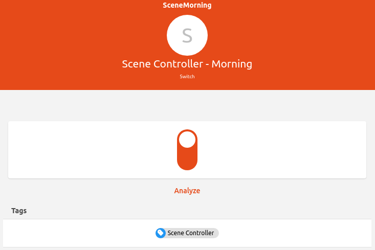

This system uses proxy items (Type: Switch) to control each scene. By doing this there is one item that holds all the metadata for one scene but also gives the user control over whether the scene is currently enabled or disabled. I find this useful for scenes where the trigger is some daily event or cron time (such as a Wake Up scene) which doesn’t need to occur when you are not at home. Each proxy item that needs to act as a scene controller only needs to have a non-semantic tag, Scene Controller added to it. No other configuration is required. I Give all of my controllers a prefix on the label such as Scene Contoller - XXXX but this is not necessary. If you do, use a hyphen in the label and the widget will only display text after the hyphen, otherwise the widget will show the entire item label.
One additional proxy item (Type: String) is required to carry information between the widget and the configuration rule. In my sample configuration, this item is named Rule_SceneModify. This can be configured in the widget, but that is the default name. If you change this default name you will also need to change the triggers and conditions of the scene modification rule (see below).

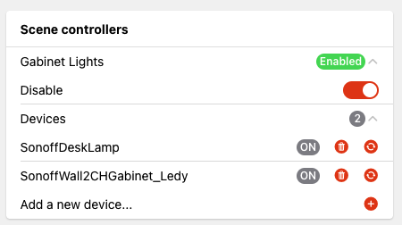

The Widget
The centerpiece of this is the UI widget. The widget starts in a basic form which displays each of the available scene controllers in a list and displays whether they are currently enabled or disabled.
Each of these is an accordion and can be expanded to show some details of the scene.
This is all fairly straightforward, the only thing that might require comment is that the badge on the devices line shows the number of devices that are currently programmed for that scene, and this devices line is also a accordion that can be further expanded to show those devices and their settings.
Adding a Device to a Scene

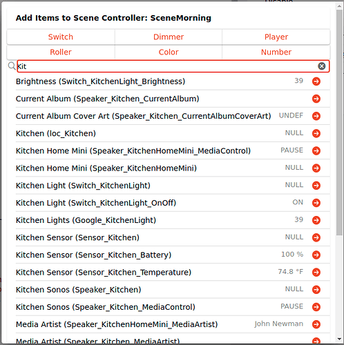

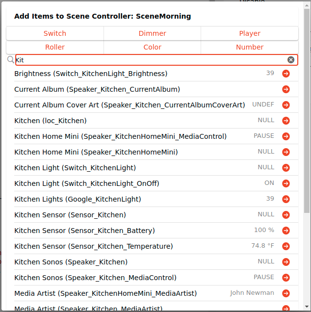

Let’s start with putting devices into the scene. The widget will record the current state of each item you add. So, the first step will be to make sure all the items you are going to want in the scene are currently set the way you want them (basically, set up the actual environment you want). Then press the plus icon on the Add a new device... line under the scene you want to add the items to. This will bring up an item selection popup.
You can toggle each of the buttons at the top to show all the items of a particular type, or you can just type in the search box to bring up items filtered by item name. When you locate the item you want, just press the red arrow. The item you select will not disappear from the list, but in the background you should see the item appear in the widget (or at least see the number of items in the badge increment). Do this for each item you want. (If you are interested in the main trick behind this item selection popup, see this post here).
Modify Devices
In the fully expanded list, each device has two buttons associated with it. The trash can, naturally, removes the device from the scene (it does not delete the actual item, it only removes the metadata in the scene controller). You should see the item disappear immediately.
deleteitem
The circular arrows allow you to update the state of the item if you decide that the scene is not quite to your liking. For example, if you have a dimmer in the scene set to 60, but decide that’s too bright, just change the dimmer item to some lower setting and then press the circular arrows to refresh the state in the scene definition to the new setting. You should see the state badge change accordingly.
refreshitem

I just tried to install your Scene-widget, but after following the whole tutorial I still get an empty box with the title “Scene Controllers” in my page. No buttons or anything. The helper libraries seems to work based on the fact that I can force trigger the scripts and it no longer complains about missing libs (it did earlier, but that has been sorted now). Any ideas what I have missed or misunderstood?
Kind regards,
Henrik
The widget populates automatically regardless of the state of the rules (rules are necessary to run the scene and to modify the scene with the widget, but if you have properly configured scene items then they should be found by the widget no matter what).
The first thing the widget does is loop through all Items with the Scene Controller tag. So make sure you have properly added that tag to at least one Switch Item. The tags are case sensitive and make sure you have the space as well. As long as that is true the item will be in the widget list. On the items details page it should look like this:
As for the rules, they may be working properly once you get the items configured. But, if you’re on the OH3.2 release, you can also get all three pieces directly form the marketplace and those are newer versions that don’t require the helper libraries which may fix whatever lingering rules issues you are experiencing.
Thank you Justin! I added the tag, but I must have failed saving it! I re-added the tag and now it works!
Hello @JustinG . Quick question. Does your widget work correctly in OH 3.3 ?
I tried to setup but can’t add any kind of device from widget webui.
I get message that device has been added but nothing happened.
in logs no errors just info:
2022-09-02 17:15:07.056 [INFO ] [openhab.event.ItemCommandEvent      ] - Item 'Rule_SceneModify' received command scene_cooking_light,BathroomBatteryLevel,ADD
2022-09-02 17:15:07.249 [INFO ] [openhab.event.ItemCommandEvent      ] - Item 'Rule_SceneModify' received command scene_cooking_light,BathroomBatteryLevel,ADD
2022-09-02 17:15:07.430 [INFO ] [openhab.event.ItemCommandEvent      ] - Item 'Rule_SceneModify' received command scene_cooking_light,BathroomBatteryLevel,ADD
anything particular I can check?
Yes, it should run just fine.
The log message you are seeing is not that an item has been added. Only that the widget has sent a command to the item which the rule uses to actually make the changes. However, if you look at the rule, you will see that the trigger for the rule should be only when the Rule_SceneModify changes. The rule should also reset the value of Rule_SceneModify item to “None” when it has completed the requested modification. This tells us that for some reason the rule did not run properly the first time you tried to trigger that change, and now every time you request the same modification the item state is not changing and the rule is not running at all.
Try adding a different item to the scene and see if that works as that will definitely cause the item to change and so should trigger the rule. If that doesn’t work, please post the logs from that attempt and also the yaml from the rule’s Code tab.

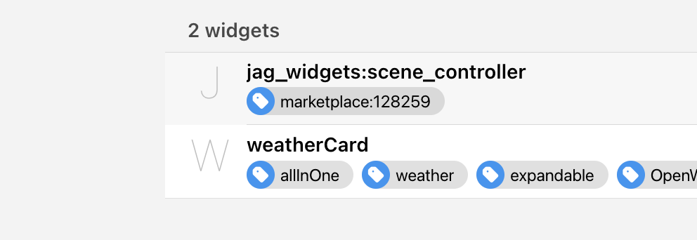

I’m lost in the installation process…
I installed all of 3 widgets:
created paths in /etc/openhab/automation which were not available lib/javascript/personal/
put manually control.js
installed 3 but still can see only one widget in the panel:
what about Activation and Modified ? I need to add them manually somehow?
If so as a widget? (I tried copy/paste but lose content after save) as a rule with activation/modified templates?
sorry for basic questions but you wrote how it works in details but I’m not sure how to install step by step if clicking into install button is not enough
This looks fairly correct so far. There is only one widget, so that is correct. The components you need to install are 1 widget and 2 rule templates, so you are only going to see one widget in the widget list.
It seems that you are struggling with the rule templates. The edit heading at the top of the post indicates that with the new rule template system you don’t have to worry any more about adding directories and putting the library file in the right place. All of that stuff is a thing of the past. Dealing with the rule templates really only takes only 2 steps and installing them from the marketplace (which you have already done) is the first step.
After you install a rule template from the marketplace, however, it is still not a rule (that’s why it’s called a rule template at this stage and not just a rule). You still have to create an actual rule using the template. To use a rule template to create a rule, you just have to go to the rules page of the UI and press the big blue + button. When the rule creation dialog comes up you will see that there is a set of options that list your available templates, so you’ll want to select the template of interest:
. Select the template and you’ll be presented with the options necessary to create the rule. The two rule marketplace pages will describe the settings you need to configure (for example, for the Modify rule, because you are using the default widget item name of Rule_SceneModify you just select that item in the configuration box, give the rule a name and a description and press save).
The most critical point to remember is that you need to only create a single version of the Scene Modify rule, but once you start making scene controllers, it will be easiest to create one Scene Activation rule for each scene controller.
Right now it’s not working because when the Rules_SceneModify item changes it’s value, there’s no OH rule that is going to respond to that change and make the required modificaiton.
thank you @JustinG for explanations. I made a lot progress :slight_smile:

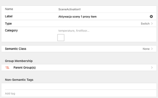

There is last thing I’m struggling with. You mentioned about:
If I create proxyItem switch to activate scene it turn on scene when change from OFF to ON but I would like to also use this undoSettings feature to deactivate scene when proxyItem change state from ON to OFF.
I tried to modify last line in the script:
from
//Activate
run_controller('scene_controller_gabinet_light',false)
to
//Activate
run_controller('scene_controller_gabinet_light',true)
but it does not work as I expected.
can you help with some example?
Wonderful.
If that is the only line of the script that you have modified, then that should work, but it does also depend on the the settings of the scene you are using. This feature is somewhat rudimentary still:
It really only works for items where it can logically reverse ON and OFF states. If you are trying to reverse other states such as dimmer levels or bulb colors or temperature settings then it can’t do that. It would greatly complicate the code to do this, so I haven’t gotten around to it yet. If you are trying to undo a scene that includes ON/OFF settings and this is not working then something has indeed gone wrong and you’ll need to show me the whole code for the rule so I can make sure that the template worked properly and show me the settings for the scene controller to make that is configured correctly.

and scene triggered by switch ON/OFF:
If I have false, then I can activate scene to the settings in controller by switching proxy switch from OFF to ON. When switching from ON to OFF nothing happened. In this case I would need to implement another activation rule for turning off scene.
run_controller(‘scene_controller_gabinet_light’,false)
2nd case when change false to true, changing switch from OFF to ON does nothing. Unless I had previously turned my lights on, then it works as you mentioned sends negative commands to all lights. But again I lose ability to activate scene and would need to implement another rule with false to be able turn on and turn off.
so again how to utilize undoSettings to have only 1 rule to activate and deactivate scene just for few simple ON/OFF lights? is there another metadata that has to be added somwhere to serve START/END or some other values?

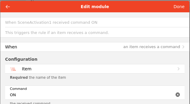

I understand the question now. There are just two steps to make this work so that your single rule can both turn the scene on and off.
  1. You have to change the trigger on the rule. Right now the rule only runs if SceneActivation1 changes to ON. It will never run when changing SceneActivation1 to OFF, but fixing that is easy
    just remove the ON in the command field. (It may be easier to just delete that trigger and build a new one without the ON command, sometimes the rules UI is unreliable when changing trigger details).
  2. Instead of always sending either just true or false as the second parameter in the run_controller function you want to build an expression that is true if the OFF command was sent and false if the ON command was sent. The variable event.itemCommand will tell us inside the rule what command caused the rule to run, so we just convert that to a string and compare it to the string 'OFF'.
event.itemCommand.toString() == 'OFF'
now just put that expression into the run_controller function:
run_controller('scene_controller_gabinet_light',event.itemCommand.toString() == 'OFF')
thank you! it works exactly as I wanted.
