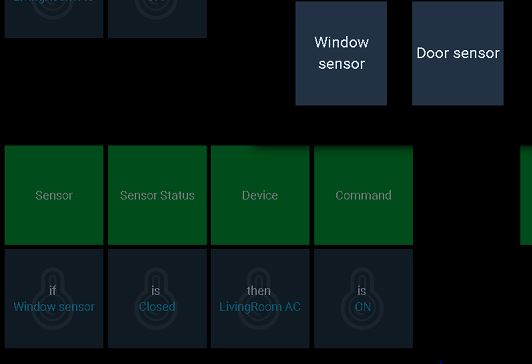

thanks for ur reply, what i want to achieve is that i want to write one rule to execute multiple tasks based on the items states from habpanel, and i dont want to keep repeating the rule for each item, im using variable item and state based on the habpanel selection… see below screenshot:
i appreciate if can help me to solve it using string state in if condition…
