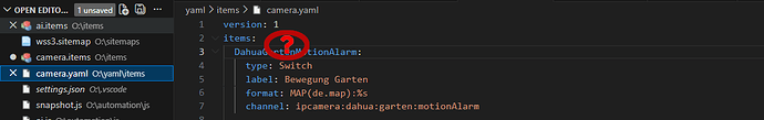

Is there any chance we can get the VS Code Extension not only for DSL, but also for the newly introduced yaml configuration in a future openHAB release?
It’s very handy and fast if you are looking for actual item states (and much more).
It’s the only thing which keeps me from switching to yaml configuration …
DSL example:
yaml example:
Good point. Imho we just need a json schema and structural highlighting should be there.
We could even upload it to schemastore so that it works across most IDEs.
I’ll definitely look into it in the next couple of days.

Schema and hightlighting is available, see
Good news everyone:
I created a json schema for the openHAB yaml files and uploaded it to schema store.
That means you can now easily get structural highlighting and auto complete for yaml files in your favorite IDE.
We can use this thread to both discuss issues and to share setup steps for IDEs.
