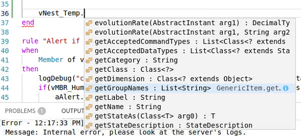

But for the most part I just use VSCode and let the code completion tell me what is available:

If OH users are writing DSL rules with nontrivial “then” Xtend scripts (or standalone Xtend scripts).. they are programmers. Maybe not professional programmers and maybe not self-identified as such, but they are programming and that’s what a programmer does. (We’ve had this discussion several times too.) Given that reality, it’s reasonable to discuss what programming tools are most effective for that purpose.
