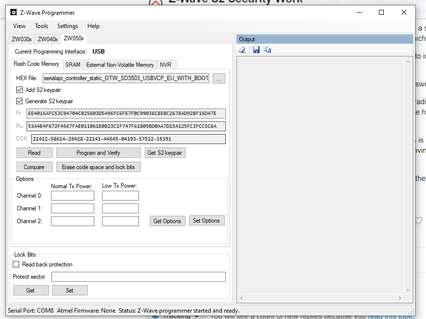

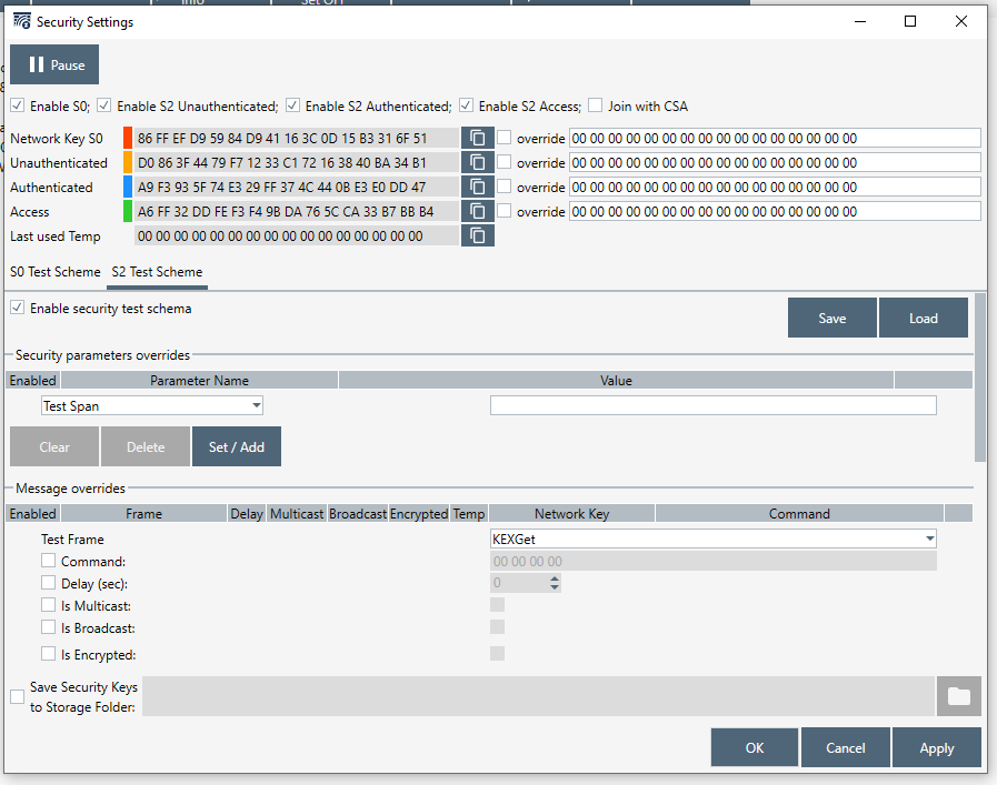

The S2 keys are in the controller firmware and most recent firmwares have the capability. A simple uzb3 does and you can set the key from the standard programmer app.
You can test using PC Controller.
your test devices will nee 6.71 or greater

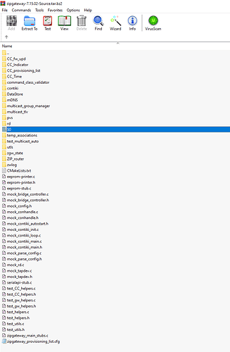

Just looked in the Z/IP source for S2 tests. This is latest distributed release.
S0 tests but can’t see any S2 tests.
S2 works from Z/IP but it is interesting that there are no tests in the source distribution.

Ah, nteresting. I download the source and found some S2 stuff under /usr/local/libs2/inclusion. I see what appears to be test cases (6000 lines long :thinking: ) and the implementation itself. That should give me what I need. Well, that and a lot of time, lol.
One thing that’s odd. I download zipgateway-2.81.03-Source.tar.bz2 from here which has files from April 2019. I see your screenshot had version 7.15.02. Did they really bump the versions that quickly in less than 2 years or are we looking at two completely different things?
Lots of small changes. The early version had distributed encryption even if you intended to run all locally. Each release makes small improvements and wraps all the complexity. I think a lot of the objections to it are because it has forced a vast change from the old direct to serial but that interface is not that easy and the way they have wrapped that and managed the queues is very effective. The latest release brought in 16 bit node id rather than 8 bit support of the past and as all is designed for backward compatibility must have the code to check what the z-wave firmware supports .
