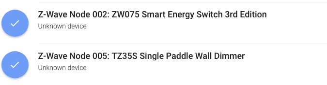

    I have a simple setup with an Aeontech ZStick Gen 5 and TKB TZ55B Dual Paddle Light Switch / Dimmer. I have sucessfully included the light switch with the stick but it shows up in openhab as a TZ35s (a single paddle switch). Therefore, there are no assoiation groups for the second paddle displayed.
Where can I start looking to get this switch correctly reported in OpenHab?

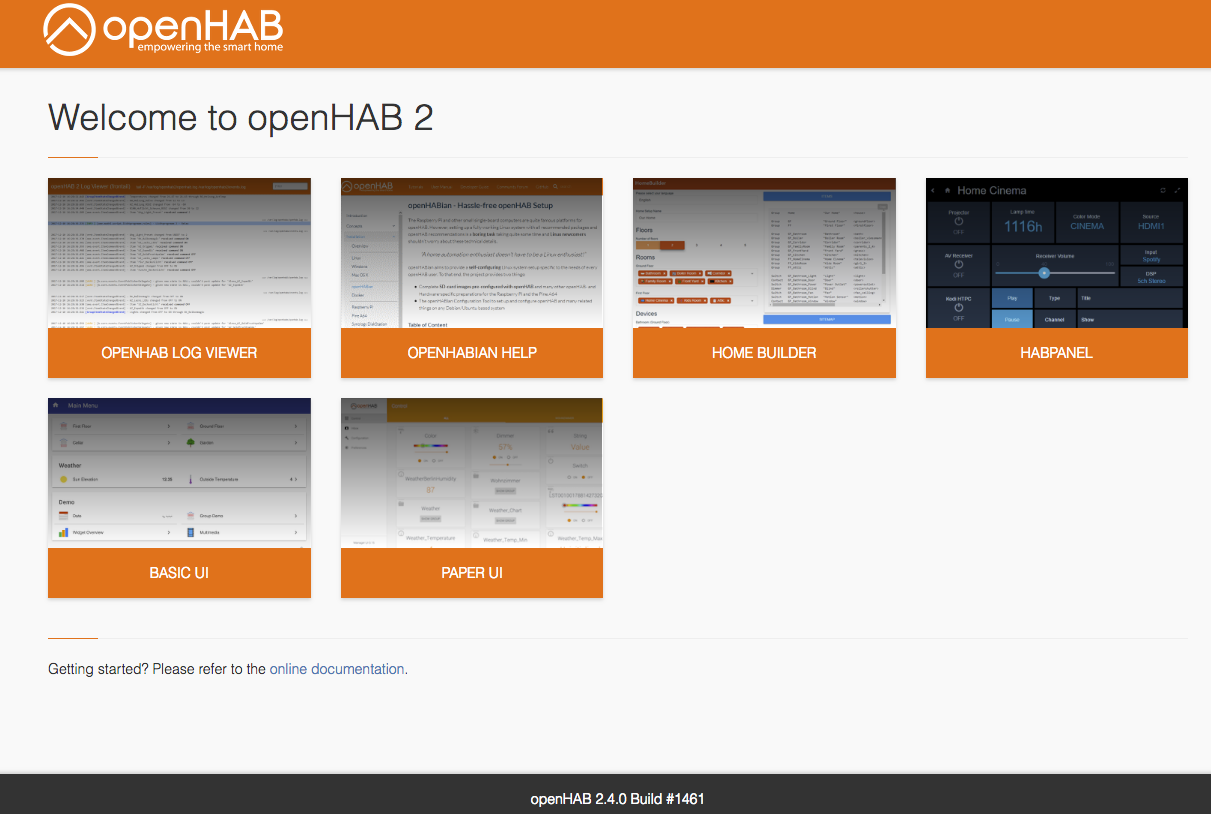

I updated to 2.4.x snapshot, removed things, removed binding, restored binding and re-added zwave devices.
Still showing as the wrong product (single paddle when it should eb a dual paddle). Anything else worth trying?

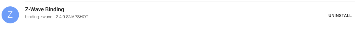

Well it looks like I’m on snapshot, not stable anymore.
I removed the zwave binding, dropped the JAR into /usr/share/openhab2/addons and restarted the system but still the same issue.

As you already found out in your above post in a snapshot release you can install the snapshot zwave binding just by hitting the install button in a GUI.
From this back and forth I would suggest to check via karaf and bundle:list | grep ZWave that only the recent snapshot binding is active.
