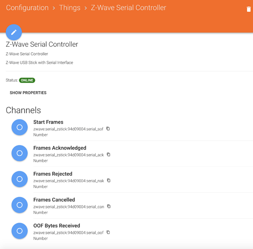

Wanted to add some pics about the configuration
2946044402
