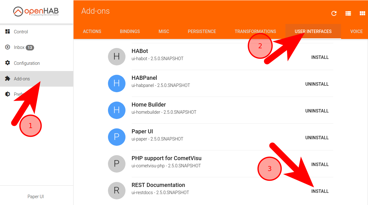

Yes just remove the line:
from that addons.config file.
Then restart openHAB and install the REST Docs via Paper UI, Add-ons, User Interfaces:
restdocs
