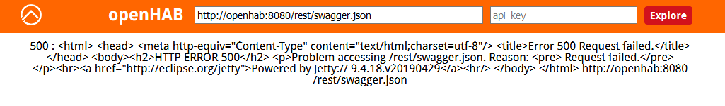

One thing NOT working is the restdcos interface. I still get this:
I recall there is a conflict between some addons and the api documentation I think it has something to do with the Jackson version required?
I saw a comment that was not resolved in M3.
The REST issue is still being worked on:
