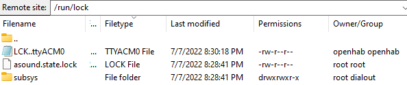

Log into the openHAB docker container: docker exec -t -i openhab /bin/bash
Access the respective folder with the lock file that shouldn’t be there cd /var/run/lock
Delete the respective file that shouldn’t be there: rm -f LCK..ttyACM0
Restart the openHAB container (in my case via Portainer)
Done.
Worked 100% of the time for me, and is at least a bit more elegant than re-creating the entire container.

I am running openhab-alpine:3.4.1 and still have problems with Serial input via /dev/ttyUSB0. I always need to delete the lock file (created by openhab user) at /var/lock/LCK..ttyUSB0 and reinitiate the Smart Meter Thing to get things working for a couple of minutes. Any ideas?
I have the same issue but on a rpi4 running Openhabian and a arduino being connected.
when trying @Cplant solution the file isn’t removed. any ideas? thanks
