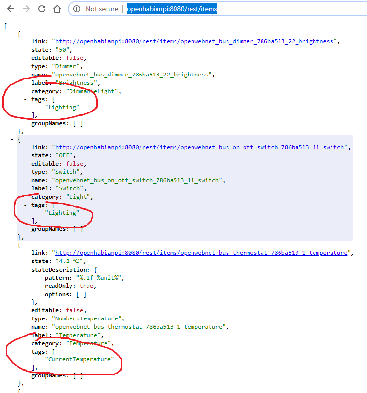

@Alberto_C how did you create this item you show in the picture?
I confirm correct tags are added if items are added automatically using PaperUI (Configuration > System > Item Linking > Simple mode > SAVE), so they are ready to go to be used by Google Home/Alexa.
Otherwise if you create items manually (via PaperUI or via .items file), then YES you have to add tags after creation.

Items have been added via PaperUI, but I did not have the simple mode active.
Thanks for the explanation.

I noticed that when you create items a Light the “Lighting” Tags are inserted while in the shutters the “” Tags is null.
My doubt, this is not why the shutters are not seen in the Homekit?
Thank you
