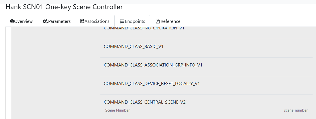

There should be a Scene Number channel (I’m using a different scene controller for demonstration purposes):
Corresponding Z-Wave database item:

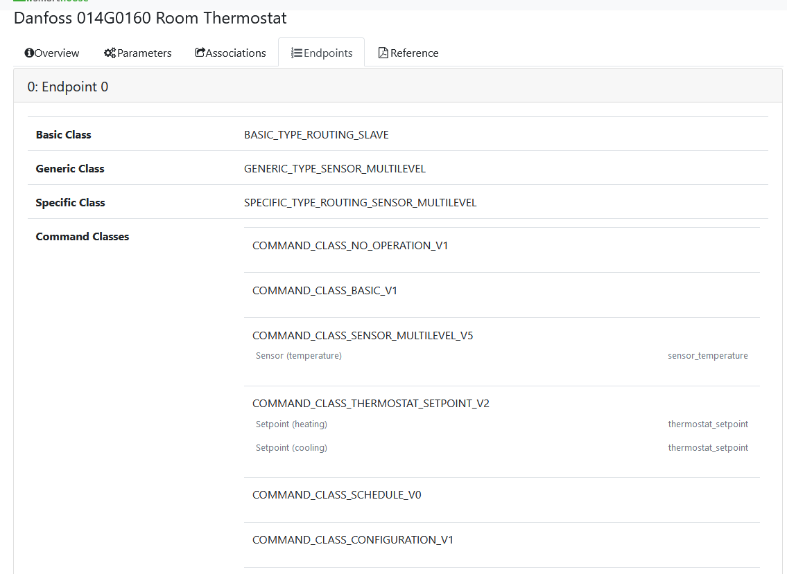

Problem:
No COMMAND_CLASS_CENTRAL_SCENE for 016G0160 in the Z-Wave database:

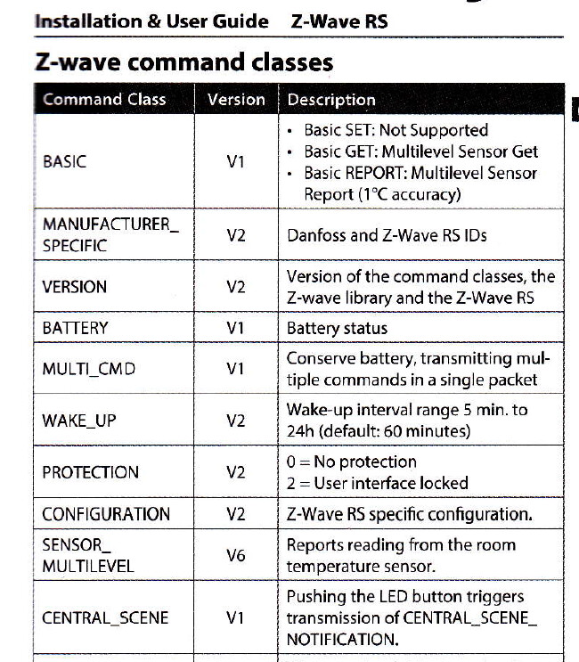

But the manual claims support for COMMAND_CLASS_CENTRAL_SCENE:

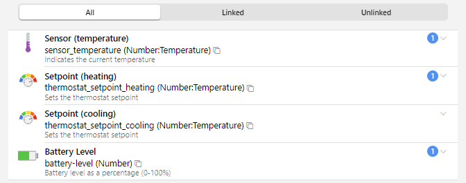

This is all I see in the channels:

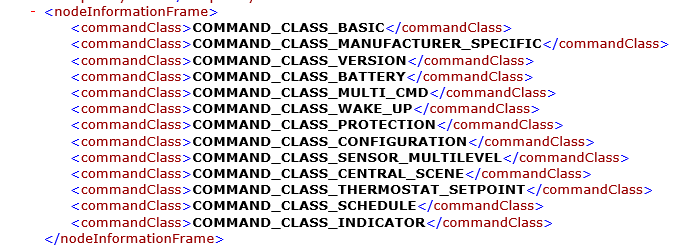

I’m running OH3.3 on windows so my xml was in a different location (openhab-3.3.0\userdata\zwave\network_ebfa9061__node_26.xml), but it does seem to be have the scene:
So I guess my xml will need uploading to the database
