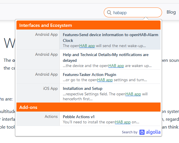

Sorry for my ignorance, but what is HABApp? Cannot find anything in the docs … :joy:
Python3 Rule engine which you can easily spin up next to openhab, normally I link it but I guess I forgot:
