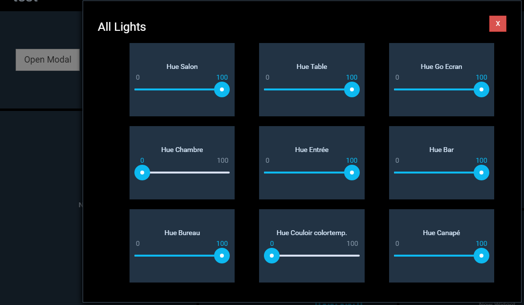

Opening a modal with sliders for each item in a group
Requires an HABPanel snapshot version from 25 Jul 2017 or later
<script type="text/ng-template" id="myModalContent.html">
<div class="container" style="padding: 30px; border: 1px solid #456;">
<a ng-click="$close()" class="pull-right btn btn-danger">X</a>
<h3 style="color: white">All Lights</h3>
<ul ng-repeat="light in itemsInGroup('Lights')" ng-init="models={}">
<li class="col-md-4"
ng-init="models[light.name] = { name: light.label, item: light.name, step: 1 }">
<div class="box" style="height: 150px; margin: 10px">
<widget-slider ng-model="models[light.name]"></widget-slider>
</div>
</li>
</ul>
</div>
</script>
<button class="btn btn-default btn-lg"
ng-click="openModal('myModalContent.html', true, 'lg')">
Open Modal
</button>
