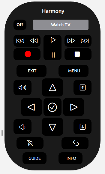

What do you think of doing it this way?
That looks great @matt1! Much better than what i put together.
Thanks for posting this, it gives me an opportunity as well to see how the Yaml in action.
I’ve started adding the Guide controls to it, using your code for refernce.
I’ll post it all when complete.
Craig
Please do as I would
Use it if you were kind enough to
Finish it off.
It’s working far better here than the official app.
You could use a background picture of a real remote, however there are at least four different designs and if someone wanted to change a picture it is very time consuming to move the buttons and links around.
I felt it was better to create a cartoon version with the most commonly used keys condensed so they all fit on a mobile screen with needing to scroll yet big enough for fat fingers to reliably press.
Look forward to seeing what you come up with.
Here is a completed Harmony widget.
Matt, I had to change actionItem to not include an underscore ( _ ) as my items do not have it as part of the name. Not sure how to get around this to make it universal. I have an Elite I used for reference, but could not get the DVR button to work so I left it off. May see about adding it another time.
This has given me that boost to see how the YAML works with Framework7. I hope to be able to create more widgets now. Thanks for your help!

    - component: f7-badge
        bgColor: black
        style:
          position: absolute
          left: 40px
          top: 210px
          width: 100px
          height: 40px
          border-radius: 12px
    - component: oh-link
        style:
          position: absolute
          top: 220px
          left: 78px
          color: white
        text: EXIT
        action: command
        actionCommand: Exit
        actionItem: =props.harmony+"ButtonPress"
        bgColor: black
        style:
          position: absolute
          left: 30px
          top: 260px
          width: 60px
          height: 50px
          border-radius: 12px
        style:
          position: absolute
          top: 272px
          left: 47px
          color: white
        iconF7: speaker_3
        iconSize: 25
        action: command
        actionCommand: VolumeUp
        bgColor: black
        style:
          position: absolute
          left: 125px
          top: 255px
          width: 70px
          height: 60px
          border-radius: 12px
        style:
          position: absolute
          top: 267px
          left: 143px
          color: white
        iconF7: arrowtriangle_up
        iconSize: 35
        action: command
        actionCommand: DirectionUp
        bgColor: black
        style:
          position: absolute
          right: 30px
          top: 260px
          width: 60px
          height: 50px
          border-radius: 12px
        style:
          position: absolute
          top: 273px
          right: 47px
          color: white
        iconF7: arrow_up_square
        iconSize: 25
        action: command
        actionCommand: PageUp
        bgColor: black
        style:
          position: absolute
          left: 55px
          top: 320px
          width: 70px
          height: 60px
          border-radius: 12px
        style:
          position: absolute
          top: 333px
          left: 71px
          color: white
        iconF7: arrowtriangle_left
        iconSize: 35
        action: command
        actionCommand: DirectionLeft
        bgColor: black
        style:
          position: absolute
          left: 130px
          top: 320px
          width: 60px
          height: 60px
          border-radius: 12px
        style:
          position: absolute
          top: 333px
          left: 142px
          color: white
        iconF7: checkmark_circle
        iconSize: 35
        action: command
        actionCommand: Select
        bgColor: black
        style:
          position: absolute
          right: 55px
          top: 320px
          width: 70px
          height: 60px
          border-radius: 12px
        style:
          position: absolute
          top: 333px
          right: 71px
          color: white
        iconF7: arrowtriangle_right
        iconSize: 35
        action: command
        actionCommand: DirectionRight
        bgColor: black
        style:
          position: absolute
          left: 125px
          top: 385px
          width: 70px
          height: 60px
          border-radius: 12px
        style:
          position: absolute
          top: 400px
          left: 142px
          color: white
        iconF7: arrowtriangle_down
        iconSize: 35
        action: command
        actionCommand: DirectionDown
        bgColor: black
        style:
          position: absolute
          left: 30px
          top: 390px
          width: 60px
          height: 50px
          border-radius: 12px
        style:
          position: absolute
          top: 404px
          left: 47px
          color: white
        iconF7: speaker_1
        iconSize: 25
        action: command
        actionCommand: VolumeDown
        bgColor: black
        style:
          position: absolute
          right: 30px
          top: 390px
          width: 60px
          height: 50px
          border-radius: 12px
        style:
          position: absolute
          top: 403px
          right: 47px
          color: white
        iconF7: arrow_down_square
        iconSize: 25
        action: command
        actionCommand: PageDown
        bgColor: black
        style:
          position: absolute
          left: 40px
          top: 450px
          width: 90px
          height: 40px
          border-radius: 12px
        style:
          position: absolute
          top: 456px
          left: 72px
          color: white
        iconF7: speaker_slash_rtl
        iconSize: 25
        action: command
        actionCommand: Mute
        bgColor: black
        style:
          position: absolute
          right: 40px
          top: 450px
          width: 90px
          height: 40px
          border-radius: 12px
        style:
          position: absolute
          top: 457px
          right: 70px
          color: white
        iconF7: arrow_uturn_left
        iconSize: 25
        action: command
        actionCommand: Back
        bgColor: black
        style:
          position: absolute
          left: 60px
          top: 500px
          width: 80px
          height: 40px
          border-radius: 12px
        style:
          position: absolute
          top: 510px
          left: 80px
          color: white
        text: GUIDE
        action: command
        actionCommand: Guide
        bgColor: black
        style:
          position: absolute
          right: 60px
          top: 500px
          width: 80px
          height: 40px
          border-radius: 12px
        style:
          position: absolute
          top: 510px
          right: 81px
          color: white
        text: INFO
        action: command
        actionCommand: Info
