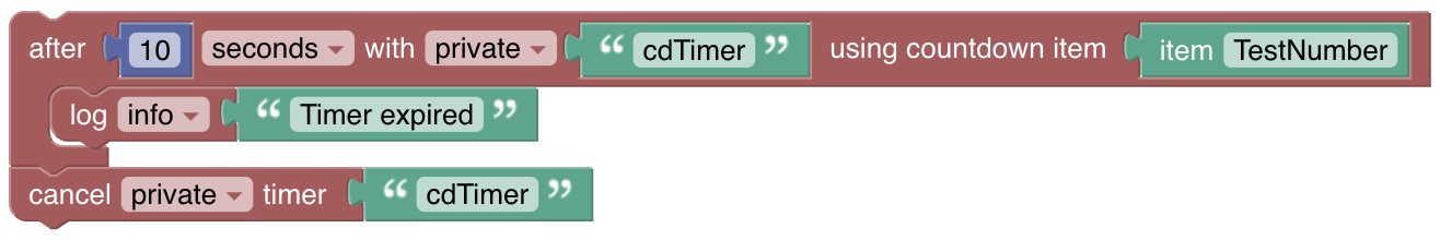

Countdown Timer
This block instantiates a CountdownTimer to run at the given time. The timer is stored in the given cache under the given name, and if there is an error in the timer, the error will be reported under that name also. Every second, the passed in countdown Item is updated with the remaining amount of time left until the Timer function is run. If the Item is a Number Item, the number of seconds left until the Timer runs is posted to that Item. If it’s a String Item, the amount of time left in HH:MM:SS format is posted to the Item.
The timer created by this block can be used with the standard “cancel” and “hasTerminated” blocks in the “Timers and Delays” category (support for the rest will be added at a future date).
The above example will schedule a timer to log “Timer expired” after ten seconds. TestNumber will be updated to 10 to start and every second it will be updated with 9, 8, and so on until the timer expires.

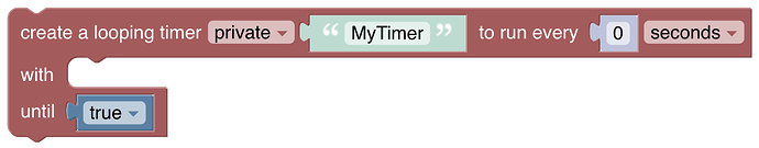

Looping Timer
Creates a timer to run after the given time and reschedules itself to run again after the same delay as long as the passed in condition evaluates to false.
The above example will log “looping timer 1 X” every second five times where X counts from 0 to 4.

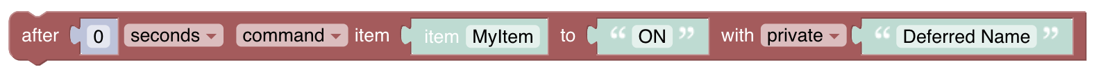

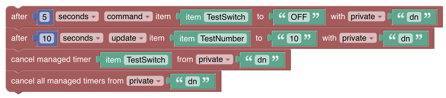

Deferred
This block lets you easily schedule a command or update to an Item at a future time. The same Deferred Object can be used to schedule commands/updates to multiple Items. There is no need to instantiate more than one.
Deferred commands/updates can be cancelled using the “cancel managed timer” and “cancel all managed timers” blocks (see below).
The above example is kind of contrived and doesn’t actually do anything.
The first block schedules an OFF command to TestSwitch in five seconds.
The second block schedules an update to 10 to TestNumber in ten seconds.
The third block cancels the scheduled command to TestSwitch.
The fourth block cancels all the scheduled commands and updates on “dn”.

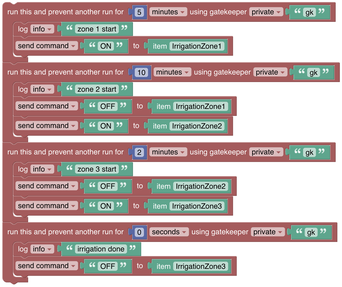

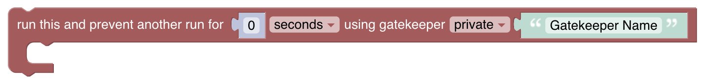

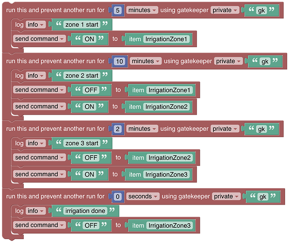

Gatekeeper
Gatekeeper is a class that allows one to space out how quickly some code can run after the last block of code ran. For example, if you have a technology that cannot handle a blast of a bunch of commands all at once, Gatekeeper can be used to space out the commands so there is some space between them.
What makes it distinct from Rate Limit is it queues up the calls and works them off in order with the given time between them. This makes it useful for other cases, such creating a sequence of timed events like one would use to control irrigation.
Gatekeeper works with the “cancel all managed timers” block (see below).
In the above example, IrrigationZone1 will be commanded ON. After five minutes it’s commanded OFF and IrrigationZone2 is commanded to ON. After ten minutes it’s commanded to OFF and IrrigationZone3 is commanded to ON. After two minutes it’s commanded to OFF. Passing a time of 0 seconds to Gatekeeper will allow subsequent calls to run immediately.

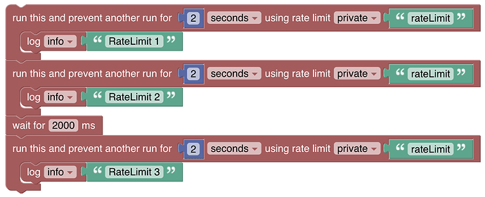

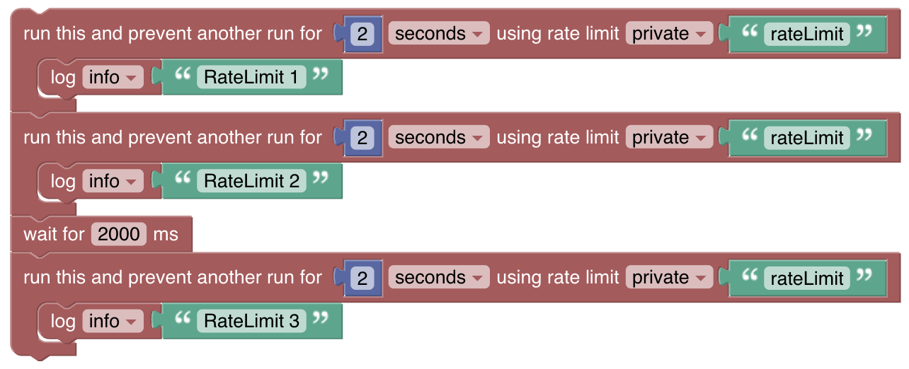

Rate Limit
This is just like Gatekeeper except that if it’s too soon after the last call to Rate Limit, the call is completely dropped instead of being queued up and run. This can be useful to debounce a noisy sensor. Calls to this block cannot be cancelled.
In the above example you will see “RateLimit 1” and “RateLimit 3” in the logs but not “RateLimit 2” because it happens before the 2 seconds are up.

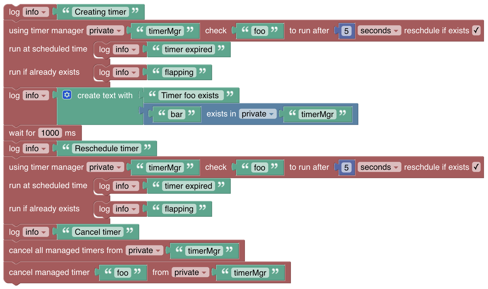

TimerMgr
TimerMgr manages one or more Timer’s entire life cycle through a simple interface. It is most useful when one has one rule that needs to manage multiple timers, one for each Item that can trigger the rule.
Property Purpose
private/shared which cache the TimerMgr is stored in
TimerMgr Name used as the key to pull the TimerMgr from the cache
“key” used as the key for the specific timer being managed
0 duration of the timer, must be a number
seconds/minutes/hours the unit of the duration
reschedule if exists when checked, if there is already a timer by the name “TimerMgr Name”, reschedule it, otherwise cancel it
run at scheduled time optional, the code to run when the timer expires
run if already exists optional, the code to run if a timer by the name “key” already exists
Timers created with this block work with the “cancel managed timer” and “cancel all managed timers” blocks (see bleow).
For example:
The above will log “Creating timer” and then create a timer named “foo” to run after five seconds. If the timer already exists it will be rescheduled for five seconds from now and “flapping” will be logged.
The next block will log “Timer foo exists false” because there is no “foo” timer scheduled. If the “bar” were changed to “true” it would log “Timer foo exists true”.
The next block waits one second. Then “Reschedule timer” is logged.
The next block behaves differently from the first because the timer already exists. You will see “flapping” in the log because the timer already exists and then the timer is rescheduled for five seconds from now. (Note: typically you’d have the one block which gets called with subsequent calls to a rule).
If we stopped there, after five seconds, it would log out “timer expired”.
If we continue you see how to cancel all timers in a timer manager and how to cancel an individual timer managed by a timer manager.

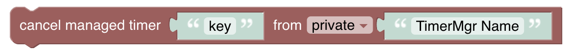

The standard cancel timer block under Timers and Delays will work for Countdown Timer but for managed timers both the manager (e.g. TimerMgr or Deferred) in addition to the “key” for the Timer itself needs to be passed. See examples above.

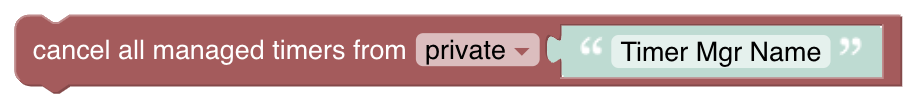

This will cancel all the managed timers that are part of a TimerMgr or Deferred manager. See examples above.

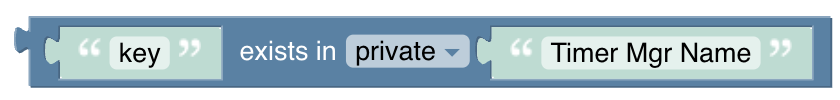

timer exists
Returns true if a timer by the given “key” exists in the given TimerMgr. See example above.

        message0: run this and prevent another run for %1 %2 using rate limit %3 %4 %5
        nextStatement: ""
        previousStatement: ""
        tooltip: Creates a rate limit Object if it does not already exist to prevent code from running too quickly after the last run. Rate limit drops calls that happen within the duration.
        type: ohrt_rate_limit
        code:
          - component: BlockCodeTemplate
              template: >
                {{utility:getRateLimit}}(cache.{{field:CACHE}}, {{input:TIMER_NAME}}).run(function() {
                    {{statements:TIMER_FUNC}}
                  }, 'PT' + {{input:DURATION}} + '{{field:UNIT}}');

        message0: cancel managed timer %1 from %2 %3
        nextStatement: ""
        tooltip: Cancels a managed timer from TimerMgr or Deferred.
        type: ohrt_cancel_managed

        message0: cancel all managed timers from %1 %2
        nextStatement: ""
        tooltip: Cancels all managed timers from Deferred, Gatekeeper, or TimerMg.
        type: ohrt_cancel_all_managed

        message0: "%1 exists in %2 %3"
        output: Boolean
        tooltip: Returns true if a managed timer exists in indicated manager.
        type: ohrt_has_managed_timer

What an amazing and sophisticated contribution :heavy_heart_exclamation:
