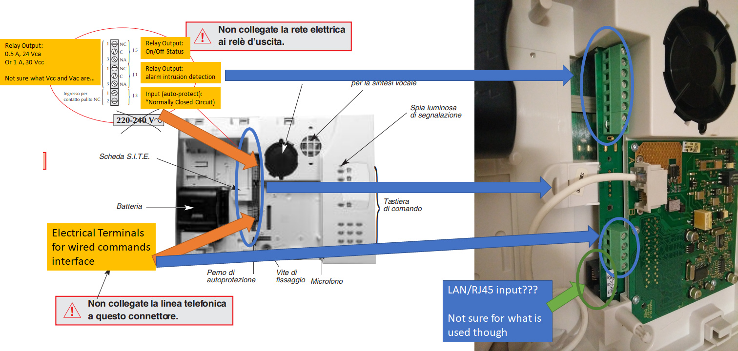

I have founded a schema of my alarm system central unit and I have also took a picture of it (uploaded here)…

  3. the circuit board of the central unit has also an Rj45 plug… not sure what is that… ides? (i do not think is the LAN connection because the allarm is about 15 year old, therefore I do not thin that there is any webserver in it…)

It is hard to give you any details without knowing the alarm system and I’m pretty sure you will need a multimeter to find the voltage level of the in- and outputs you are seeing in your alarm central.
In general: if you need more than one I/O the Fibaro Universal Sensor is a bad choice because it only provides an input to the openHAB system, not an output. And it gets pretty expensive if you need to buy several devices :smiley:
I would go for the ESP8266 (easiest to connect is the nodemcu version) or any other microprocessor (read the linked posts for other ideas) to connect your alarm pins to openHAB. It also can drive relays to switch your alarm state ON/OFF.
Communication between your router and the ESP is done via Wifi, the status (In and Out) is established via MQTT. Inputs up to 5V can directly be wired to the ESP pins, outputs can be done via a variety of available relays. If you need a voltage free ouput this can be done without relays.
You need to flash a new firmware to the ESP for this.
A lot of users run their openHAB on an RPi. In my opinion using it as sensor I/O is to expensive. You can have this a lot cheaper with microprocs like the ESP’s.

Based solely on experience with alarms of this period (i.e. guessing) - the “wired commands interface” is probably a serial RS232 port, which would allow an external system to interrogate and control the alarm. Really useful!
But sadly, unless you can get the manufacturer’s specification for the data protocol used, not much chance of exploiting that. As a security system, that is likely been made deliberately difficult.
One approach might be to find out if there is a PC application around that will talk to the alarm. You could then monitor the data traffic and figure out essential commands and data. Very tedious!
I would guess again, that the RJ45 socket is another way to the same serial port, perhaps an RS485 version. It’s not likely to be a LAN port, that would usually be an add-on option.
I don’t think you’ll be able to remotely set or unset this alarm system without this knowledge. However - if you have the installer’s manual it might describe how to control the alarm from a keyswitch instead of keypad. Such a keyswitch could be simulated by a relay under OpenHAB control.
As sihui says, there are many ways to connect two binary sensors for alarm on/off and alarm normal/ringing indication (and possible relay for alarm enable/disable). You might want to decide how your home system might develop in the future, to help choose a suitable technology here - zwave, KNX, WiFi ESP, blah.
