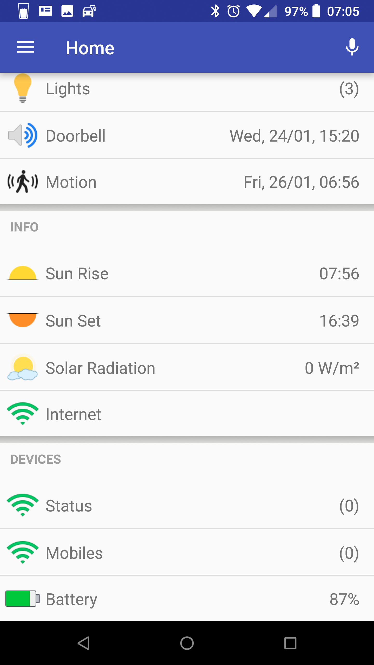

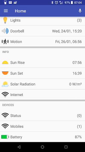

Still not working for me. In the screenshots below you can see the network icons are black (undefined) when using remote. If I clear the image cache from the app I usually get a different set of incorrect icons.
Local:
Remote:
