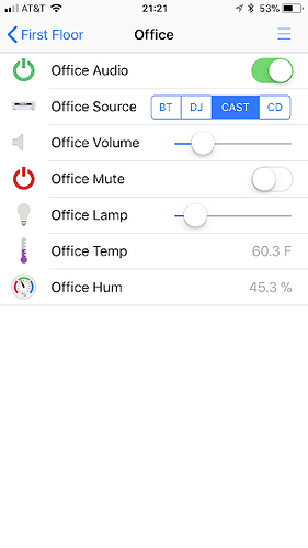

Frame label="MonoPrice" {
		Switch item=MonoPrice_Refresh
		//Text item=AudioMTX_Receive
		//Text item=MonoPrice_Status
		//Text item=MonoPrice_Status_G1
		// Text item=MonoPrice_Status_G2
		// Text item=MonoPrice_Status_G3
		// Text item=MonoPrice_Status_G4
		// Text item=MonoPrice_Status_G5
		// Text item=MonoPrice_Status_G6
		// Text item=MonoPrice_Status_G7
	    // Text item=MonoPrice_Status_G8
		// Text item=MonoPrice_Status_G9
		// Text item=MonoPrice_Status_G10
		// Text item=MonoPrice_Status_G11
		Text item=MonoPrice_Z11
		Switch item=MonoPrice_Z11_Power
		Selection item=MonoPrice_Z11_Source label="Zone 1 Source" mappings=[1=CH1,2=CH2,3=CH3,4=CH4,5=CH5,6=CH6] visibility=[MonoPrice_Z11_Power==ON]

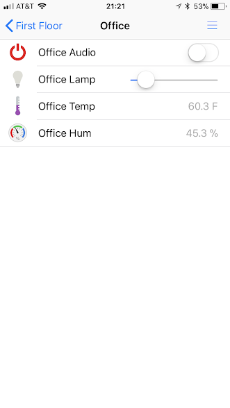

		Slider item=MonoPrice_Z11_Volume visibility=[MonoPrice_Z11_Power==ON]
		Switch item=MonoPrice_Z11_Mute visibility=[MonoPrice_Z11_Power==ON]
		Slider item=MonoPrice_Z11_Treble visibility=[MonoPrice_Z11_Power==ON]
		Slider item=MonoPrice_Z11_Bass visibility=[MonoPrice_Z11_Power==ON]
		Slider item=MonoPrice_Z11_Balance visibility=[MonoPrice_Z11_Power==ON]
		Text item=MonoPrice_Z12
		Switch item=MonoPrice_Z12_Power
		Selection item=MonoPrice_Z12_Source label="Zone 2 Source" mappings=[1=CH1,2=CH2,3=CH3,4=CH4,5=CH5,6=CH6] visibility=[MonoPrice_Z12_Power==ON]
		Slider item=MonoPrice_Z12_Volume visibility=[MonoPrice_Z12_Power==ON]
		Switch item=MonoPrice_Z12_Mute visibility=[MonoPrice_Z12_Power==ON]
		Slider item=MonoPrice_Z12_Treble visibility=[MonoPrice_Z12_Power==ON]
		Slider item=MonoPrice_Z12_Bass visibility=[MonoPrice_Z12_Power==ON]
		Slider item=MonoPrice_Z12_Balance visibility=[MonoPrice_Z12_Power==ON]
		Text item=MonoPrice_Z13
		Switch item=MonoPrice_Z13_Power
		Selection item=MonoPrice_Z13_Source label="Zone 3 Source" mappings=[1=CH1,2=CH2,3=CH3,4=CH4,5=CH5,6=CH6] visibility=[MonoPrice_Z13_Power==ON]
		Slider item=MonoPrice_Z13_Volume visibility=[MonoPrice_Z13_Power==ON]
		Switch item=MonoPrice_Z13_Mute visibility=[MonoPrice_Z13_Power==ON]
		Slider item=MonoPrice_Z13_Treble visibility=[MonoPrice_Z13_Power==ON]
		Slider item=MonoPrice_Z13_Bass visibility=[MonoPrice_Z13_Power==ON]
		Slider item=MonoPrice_Z13_Balance visibility=[MonoPrice_Z13_Power==ON]
		Text item=MonoPrice_Z14
		Switch item=MonoPrice_Z14_Power
		Selection item=MonoPrice_Z14_Source label="Zone 4 Source" mappings=[1=CH1,2=CH2,3=CH3,4=CH4,5=CH5,6=CH6] visibility=[MonoPrice_Z14_Power==ON]
		Slider item=MonoPrice_Z14_Volume visibility=[MonoPrice_Z14_Power==ON]
		Switch item=MonoPrice_Z14_Mute visibility=[MonoPrice_Z14_Power==ON]
		Slider item=MonoPrice_Z14_Treble visibility=[MonoPrice_Z14_Power==ON]
		Slider item=MonoPrice_Z14_Bass visibility=[MonoPrice_Z14_Power==ON]
		Slider item=MonoPrice_Z14_Balance visibility=[MonoPrice_Z14_Power==ON]
		Text item=MonoPrice_Z15
		Switch item=MonoPrice_Z15_Power
		Selection item=MonoPrice_Z15_Source label="Zone 5 Source" mappings=[1=CH1,2=CH2,3=CH3,4=CH4,5=CH5,6=CH6] visibility=[MonoPrice_Z15_Power==ON]
		Slider item=MonoPrice_Z15_Volume visibility=[MonoPrice_Z15_Power==ON]
		Switch item=MonoPrice_Z15_Mute visibility=[MonoPrice_Z15_Power==ON]
		Slider item=MonoPrice_Z15_Treble visibility=[MonoPrice_Z15_Power==ON]
		Slider item=MonoPrice_Z15_Bass visibility=[MonoPrice_Z15_Power==ON]
		Slider item=MonoPrice_Z15_Balance visibility=[MonoPrice_Z15_Power==ON]
		Text item=MonoPrice_Z16
		Switch item=MonoPrice_Z16_Power
		Selection item=MonoPrice_Z16_Source label="Zone 6 Source" mappings=[1=CH1,2=CH2,3=CH3,4=CH4,5=CH5,6=CH6] visibility=[MonoPrice_Z16_Power==ON]
		Slider item=MonoPrice_Z16_Volume visibility=[MonoPrice_Z16_Power==ON]
		Switch item=MonoPrice_Z16_Mute visibility=[MonoPrice_Z16_Power==ON]
		Slider item=MonoPrice_Z16_Treble visibility=[MonoPrice_Z16_Power==ON]
		Slider item=MonoPrice_Z16_Bass visibility=[MonoPrice_Z16_Power==ON]
		Slider item=MonoPrice_Z16_Balance visibility=[MonoPrice_Z16_Power==ON]

@mrfrenzy
Here’s what my sitemap looks like (I haven’t incorporated @swamiller 's code improvements into my setup yet, but you’ll get the idea:
OFF:
ON:
I’ve connected 4 inputs on my amp, but mostly use the Chromecast Audio I have connected to it. I have 4 zones outputting around the house and in my shed.
