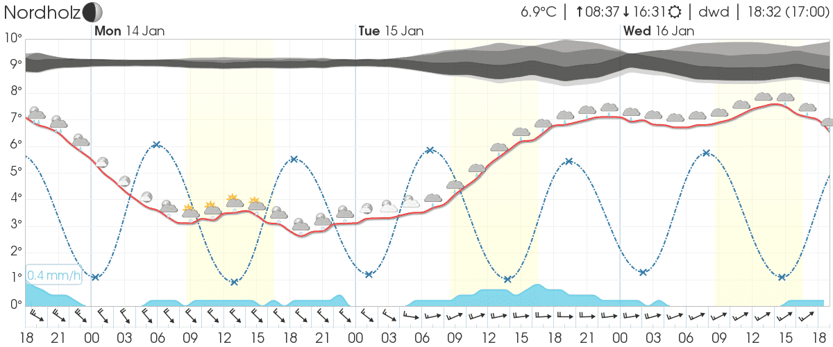

Not a real binding, but I’m using Meteograms. In my case the data is from dwd ( Deutscher Wetter Dienst).
When updating every 2 hours, the number of monthly updates is free.

You’d better look into the posted website. The output can be customised to your needs (serviceprovider, updaterate, data provided, presentation,…)
My actual web call looks like:
https://nodeserver.cloud3squared.com/getMeteogram/%7B%22token%22%3A%22MyAPIToken%22%2C%22chartWidth%22%3A%221200%22%2C%22chartHeight%22%3A%22500%22%2C%22place.......
Which gives me:
In other words: pretty shitty weather in here!

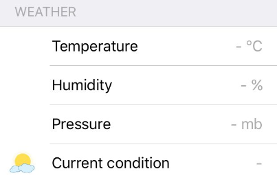

Sitemap
Frame label="Weather" {
                Text item=Temperature2
				Text item=Humidity2
				Text item=Pressure2
				Text item=owmCurrentCondition

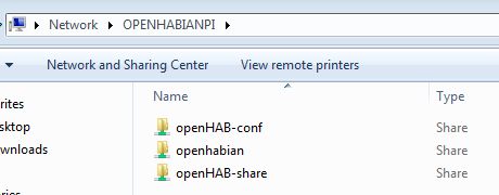

Slightly confused where to find
/var/lib/openhab2/config/org/openhab/weather.config
I use openhab vs 2.3.0 on openhabian / RPI3.
I normally tweak files inside openHAB-conf.
For logs I need to visit openHAB-share.
Sorry if this is dumb question…
