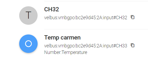

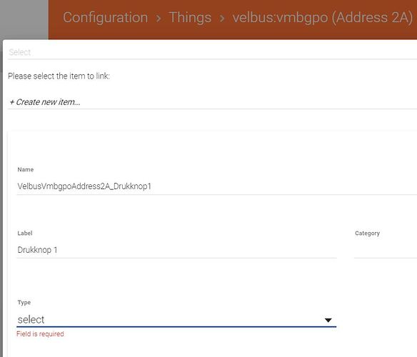

The problem I can fill the “type” field…
see screenshot.
I use at this moment only papergui
I see
You don’t need to add an item to Thing.
Simply because Trigger Channels can’t be linked to Items.
But..
You can reference Triggers directly in DSL rules
You just need to start with the rule text as above and insert the channel code to match your own panel
You can click on the double boxes to copy the text to your pc clipboard

so it is normal that I can’t program this functions in the paperui ? (buttons are not linkable (blue))
SSH is working now, the password is openhabion and not habopen !:grinning:
Hi
It looks like you’ve got a perfect understanding now :smile:
It is normal for Trigger Channels not to be configurable within PaperUI, I’ve never really asked why, as the DSL rules / Node-Red have made everything work so far.
