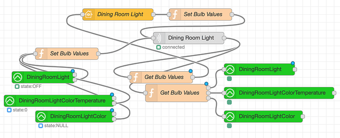

A snapshot of the node-red nodes would be worth a thousand words too. Thanks
Here’s a screenshot of the Node-RED spaghetti/
I actually intended to in my original post, but I forgot.
