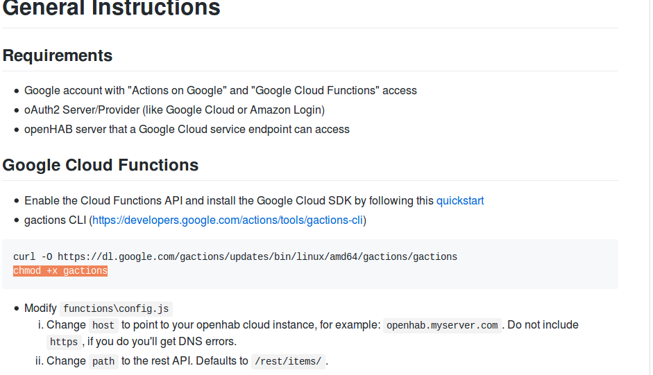

Following this tutorial I can’t understand the modify functions\config.js part , where exactly is this file?? I’m new to this and I’m using a ubuntu 16.4 system .
Till now I have finished installing google cloud and g actions.
You shouldn’t use these instructions.

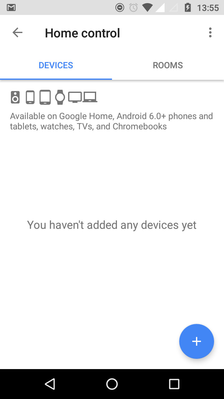

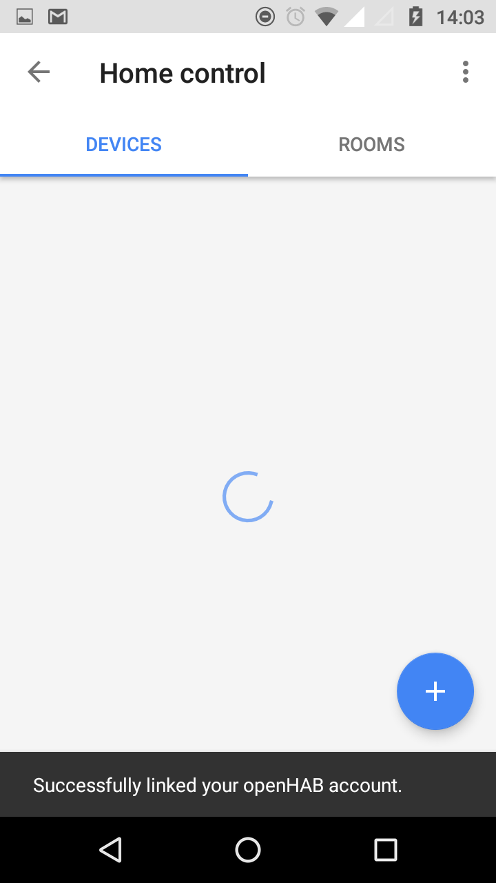

Initially I opened home control on my google assistant app and in add devices searched for openhab and i clicked on it , the app displays your accounts have been linked successfully but then it does not display the openhab as a device it just displays you haven’t added any device.

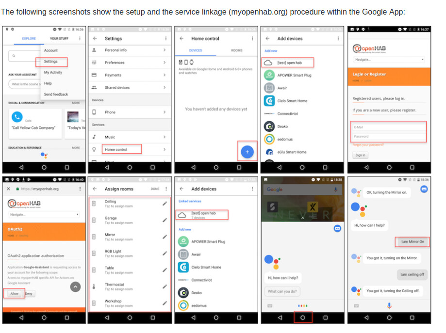

I have attched the screenshot from the tutorial as well as the scrennshots of when I did the same thing that as in the tutorial.

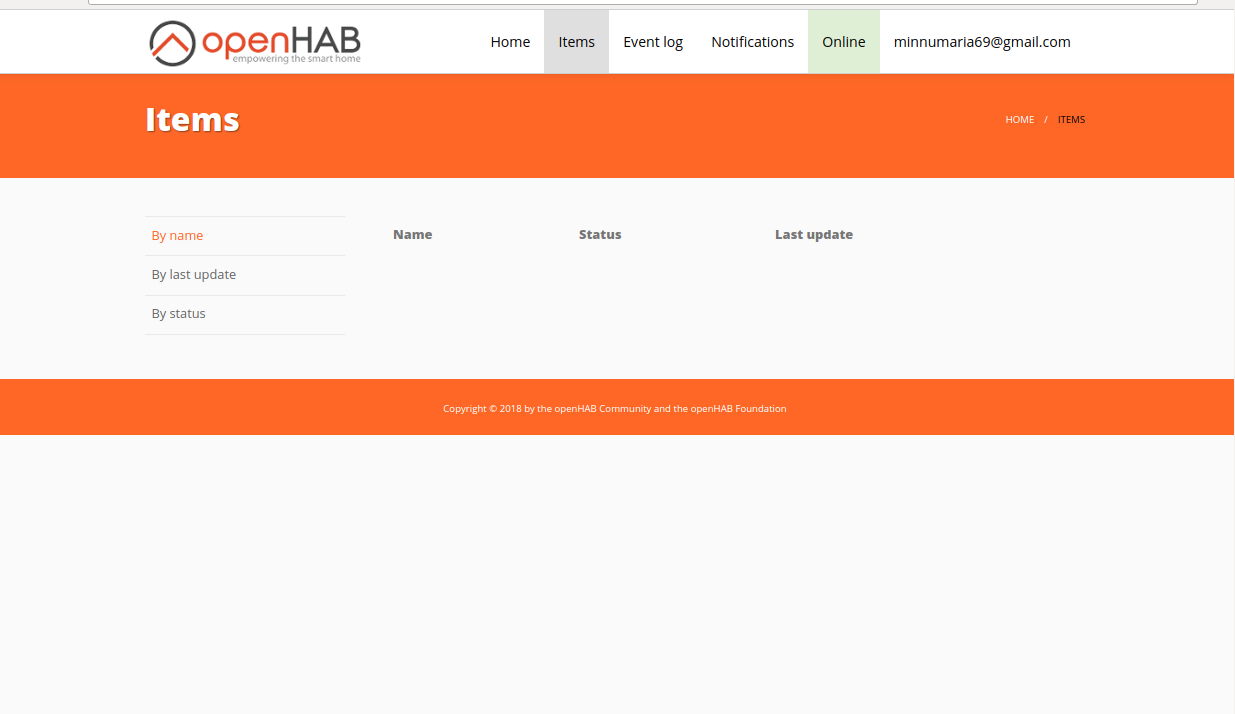

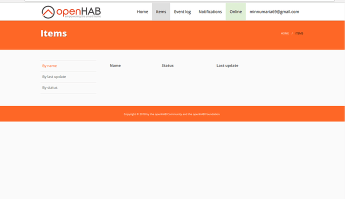

I have created a basic ui with switchable light but that’s not how I do it?
i have attched a screenshot of my dashboard I haven’t aded any items.
Are you using PaperUI or *.items files to define/create your items?
Basic UI

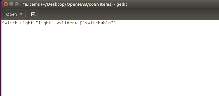

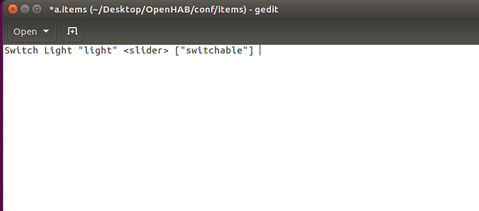

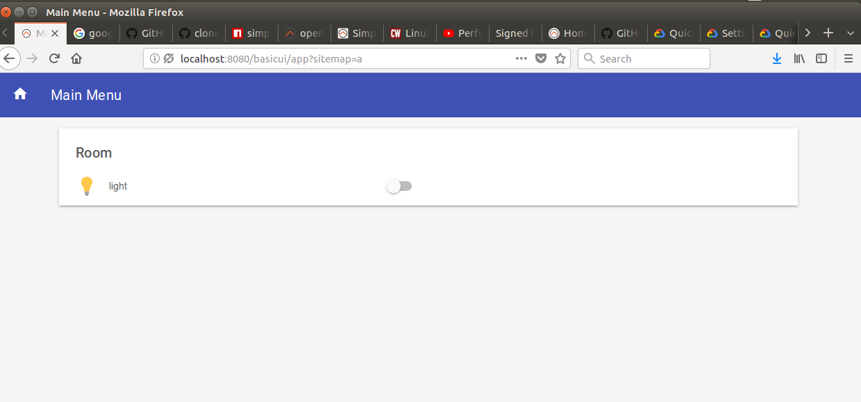

I have attached the screenshot of how my basic UI looks and also the code in items.
BasicUI is used to parse and display *.sitemap files (not *.items). Of course, within your sitemap, you refer to items.
Try Switchable (instead of switchable)… maybe? this is the problem.
You can copy paste the code here with Code Fences (to avoid using screenshots)
Switch Light "light" <slider> [ "Switchable" ]
Alright.
So should I write this in sitemaps or items??
within your ~/Desktop/OpenHAB/conf/items/a.items file
Thank you. Works fine now

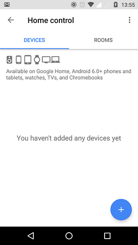

But when i add, it gets paired successfully but device does not show up in my devices (Similar to mmj6 Jun 11 post) section of google assistant.

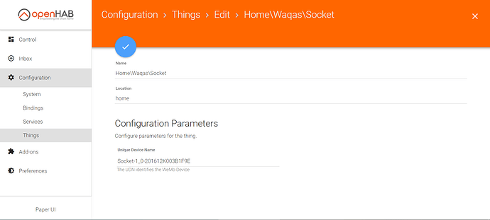

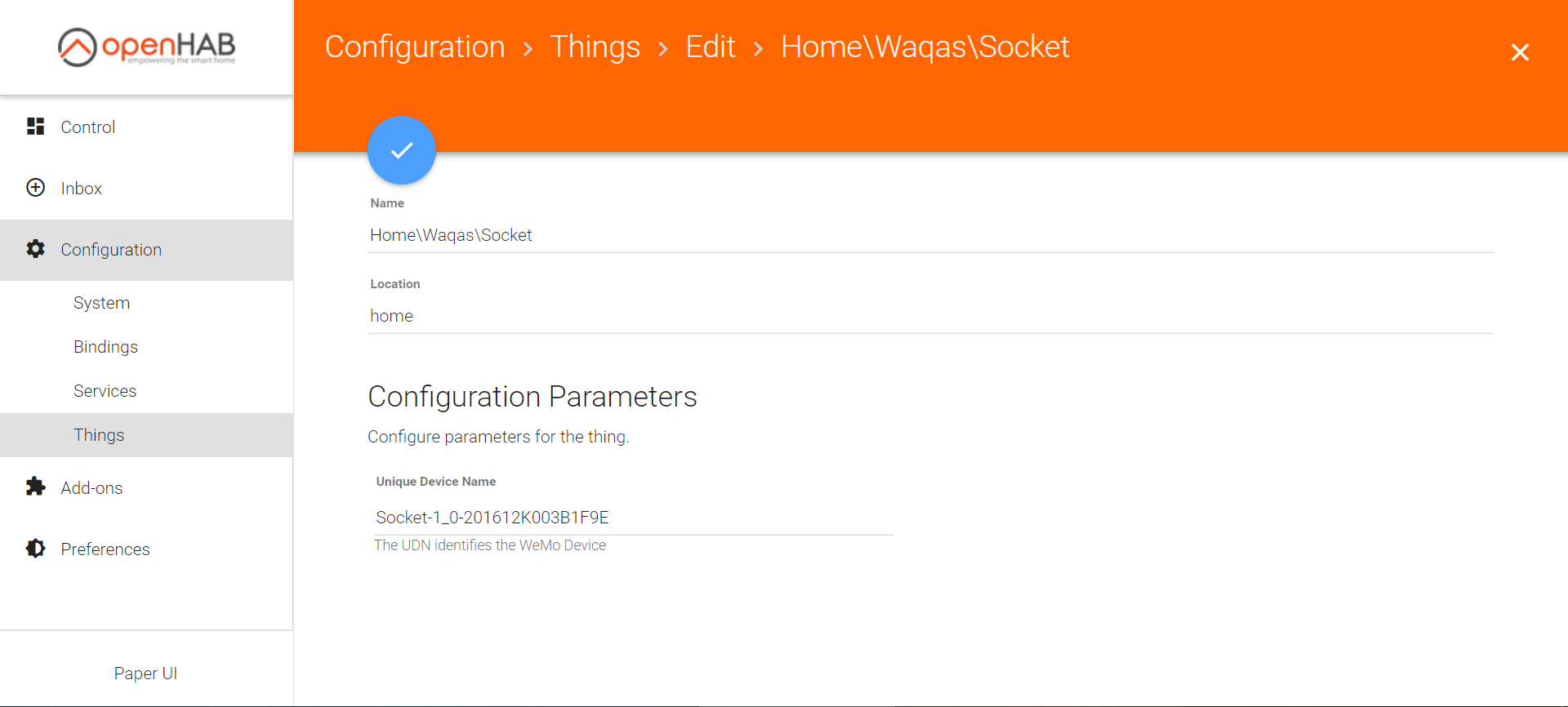

I am not new to IOT Field, but I am new to openhab. Where to add labels, I can see the following screen on edit.
. More over can you suggest some guide for adding tags via REST API / Console?
To edit your Items within PaperUI you need to:
PaperUI->Configuration->System->Item Linking->Turn off “Simple Mode”
You will be then presented with a new menu on the left side (just below the one that you have selected now (Things).
You can then edit the Items and add Labels
