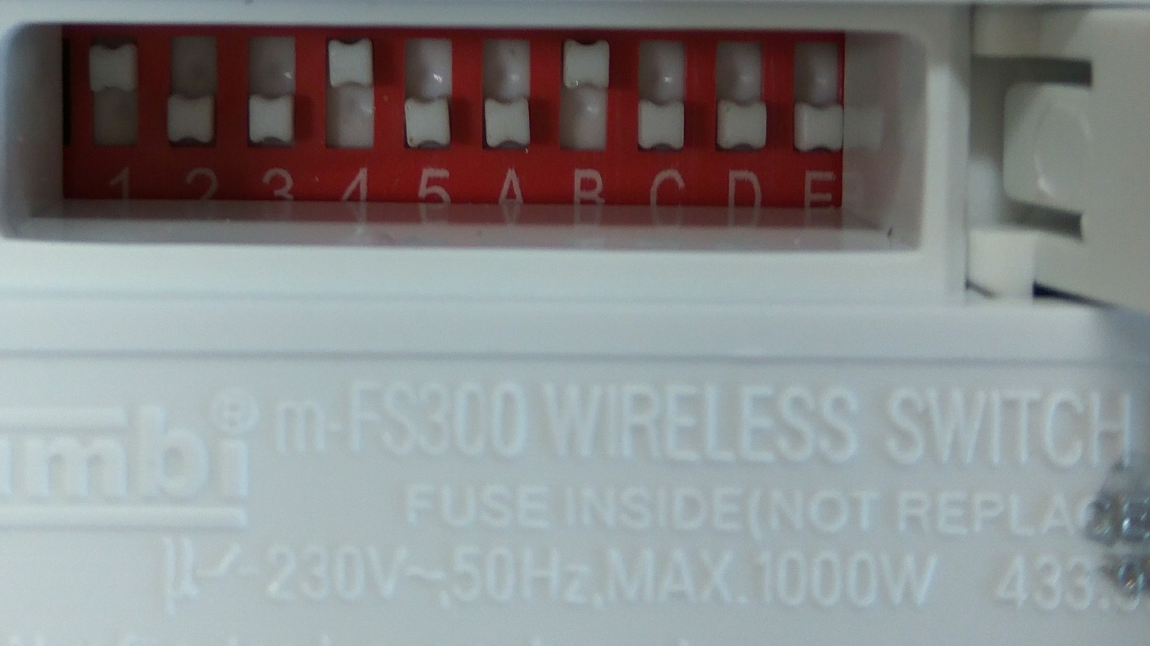

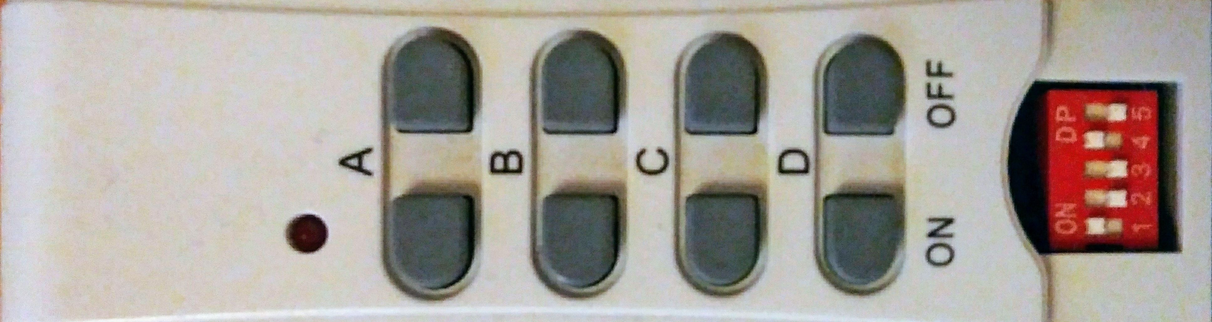

This is the remote which is delivered with the power plugs, it can control 4 devices A, B, C, D.
I configured my device to match the Address 10010 and the device B(2) as seen in the picture. Replace the Address and the device number to match your setting.
Try sending a command to your device with ./send <Address> <Device Number> <On/Off>.

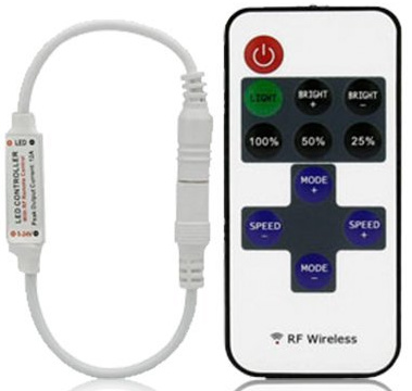

LED Stripes
Additionally i post my solution for some LEDs stripes.
This is the LED controller and the RF remote.
I decoded the commands which the remote sends with RFSniffer from 433Utils which also contains send and sendcode to controll the transceiver.
So getting it done is then straight forward, just add a thing, items, a sitemap and a rule to controll the LED stripe.

    try {
      // Lock transmitter so other executed rules dont't use it at the same time
      transmitter.lock()
      // Manual reset, somehow it get stuck sometimes.
      // This avoids a lock when state of Remote_CodeSend is not updated properly.
      Remote_CodeSend.sendCommand(OFF)
      switch triggeringItem.name {
        case "LED_Stripe_OnOff"     : Remote_CodeSend_Args.sendCommand("11607809")
        case "LED_Stripe_LightMode" : Remote_CodeSend_Args.sendCommand("11607812")
        case "LED_Stripe_BrightUp"  : Remote_CodeSend_Args.sendCommand("11607813")
        case "LED_Stripe_BrightDown": Remote_CodeSend_Args.sendCommand("11607814")
        case "LED_Stripe_100"       : Remote_CodeSend_Args.sendCommand("11607815")
        case "LED_Stripe_50"        : Remote_CodeSend_Args.sendCommand("11607816")
        case "LED_Stripe_25"        : Remote_CodeSend_Args.sendCommand("11607817")
        case "LED_Stripe_ModeNext"  : Remote_CodeSend_Args.sendCommand("11607819")
        case "LED_Stripe_ModePrev"  : Remote_CodeSend_Args.sendCommand("11607821")
        case "LED_Stripe_faster"    : Remote_CodeSend_Args.sendCommand("11607823")
        case "LED_Stripe_slower"    : Remote_CodeSend_Args.sendCommand("11607825")
        default                     : logInfo("LED", "Error in switch!")
      // Manual trigger transmitter
      // If Remote_CodeSend_Args is set to the same value it does not trigger
      // when autorun=true, so set autorun=false and use manual trigger to be
      // able to trigger one command multiple times.
      Remote_CodeSend.sendCommand(ON)
      // Wait for the command to complete.
      while(Remote_CodeSend.state != OFF){
         Thread::sleep(100)
      //logInfo("LED_Stripe",
      //        Remote_CodeSend_Out.state.toString.replaceAll("\r|\n"," ") )
      // Reset switch signalize command is finished.
      triggeringItem.postUpdate(OFF)
    }catch(Throwable t) {}
    finally {
        transmitter.unlock()
