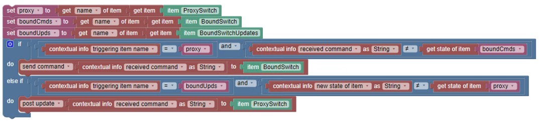

Blockly
Trigger the rule on commands to the ProxySwitch and updates to BoundSwitchUpdates.

        //logInfo("light.rules switch received command", "STARTED")
     // getting here the command Item object related to the same lights virtual switch which triggered this rule
     val relCommand = gCommands.members.findFirst[c| c.name == triggeringItem.name.split("_").get(0) + "_Command"]
        //logInfo("light.rules switch received command", "triggeringItem.name=[{}]",triggeringItem.name)
        //logInfo("light.rules switch received command", "virtSwitch.name=[{}]",triggeringItem.name)
    switch(triggeringItem.name){
        case "LRLights_VirtualSwitch": {
                //logInfo("light.rules switch received command", "case: LRLights_VirtualSwitch")
            if(receivedCommand == ON) {
                // additional ON logic, e.g. check presence, time of day, motion detectors, set/unset a flag, etc.
                relCommand.sendCommand(ON) // forward the command
                    //logInfo("light.rules switch received command", "send command: ON to:[{}]",relCommand.name)
            else {
                // additional OFF logic, e.g. check presence, time of day, motion detectors, set/unset a flag, etc.
                relCommand.sendCommand(OFF) // forward the command
                    //logInfo("light.rules switch received command", "send command: OFF to:[{}]",relCommand.name)
        //case "LRLights2_VirtualSwitch": {}
rule "State item received update"// so the relay state has changed, via virtual switch above or via wall switch, so ESP is informing (confirming) openhab about it's new state
    Item LRLights_State received update //or
    //Item LRLights2_State received update or
    //getting here the virtual switch item object which is related to the relay/light that changed it's state so I can update the new state to the virtual switch
    val virtSwitch = gVirtualSwitches.members.findFirst[c| c.name == triggeringItem.name.split("_").get(0) + "_VirtualSwitch"]
        logInfo("light.rules state received update", "triggeringItem.name=[{}]",triggeringItem.name)
        case "LRLights_State": {
            if(triggeringItem.state == ON) {
                virtSwitch.postUpdate(ON) // forward the command
            else {
                virtSwitch.postUpdate(OFF) // forward the command
        //case "LRLights2_State": {}
