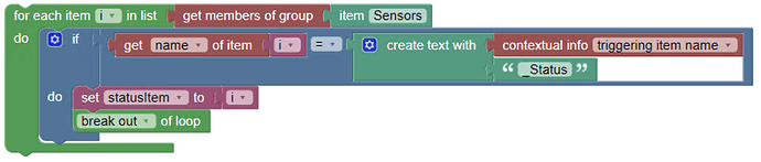

Group Membership
If you are not using the semantic model you can still use Group membership and various criteria to access an associated Item. This approach requires the rule to hard code the parent Group into the rule to search for.
Blockly
The above gets the member of the Group Sensors whose name is the name of the triggering Item with “_Status” appended to it. Note there is no error checking for the case where such Item doesn’t exist. Replace the condition blocks plugged into the “if” to use other criteria (e.g. tags, metadata, etc.).
